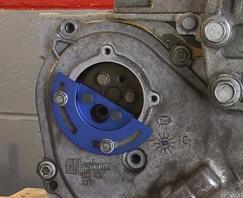

This lisle tool , shows how it holds the water pump gear in place , this way the balance shaft chain is held in position, and you don’t have to remove the front cover.
