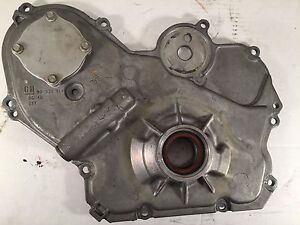

Seeing as the water pump bolt gets torqued to 18 ft/lbs and the serpentine belt tensioner bolt gets 37 ft/lbs, possibly just tightening the lower 5 or 6 cover bolts will cure the problem
