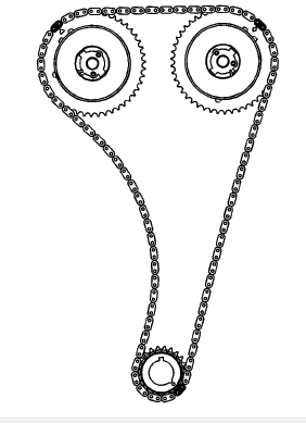

Note the phaser timing marks 2 o’clock on the intake and 10 o’clock on the exhaust You might be 180 degrees out.
