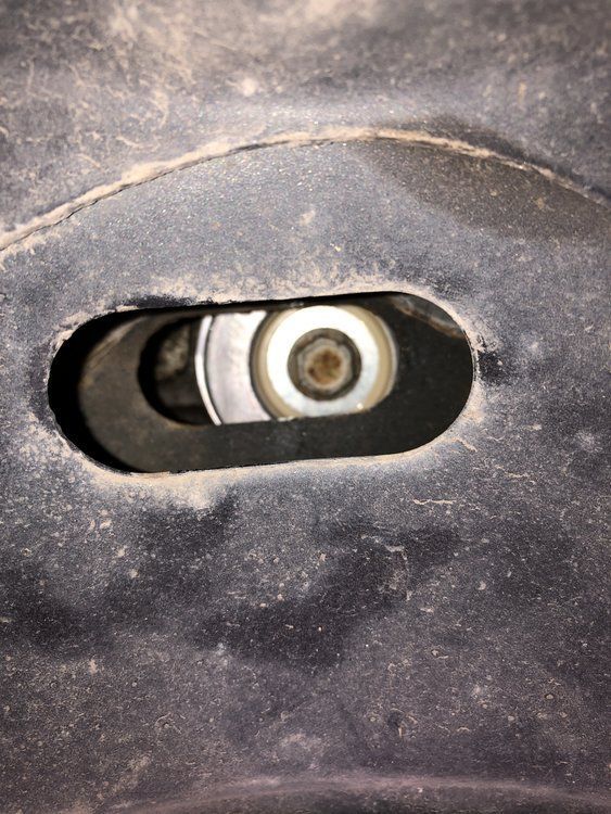

And check the upper engine mount, the bolt head should be in the middle of the access slot, if it’s low the mount is toast. That will cause a vibration and can have a metal to metal clunk
