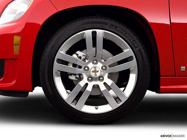

The aluminum should be nice you could maybe start with 800 grit then 1,000, then 1,500 and the 2,000 , buff and polish and keep them nice with a spray wax . I did not clear coat my wheels
