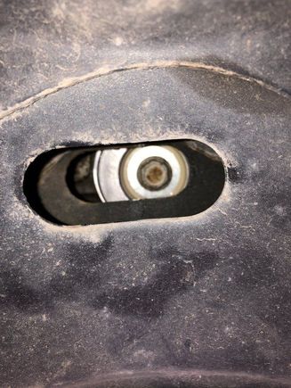

To check that upper engine mount , simply look in the passenger side front wheel well, in the oblong hole, you should see the serpentine belt tensioner bolt, it should be up in the middle, if it’s lower and appears like you couldn’t get a socket on it, the upper engine mount is toast!
