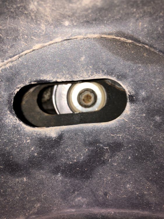

Oldblue June 28, 2021
The bolt for the serpentine belt tensioner should be in the middle of the slotted hole inside the passenger side front wheel well. If it’s low in the hole, the engine mount is toast!
