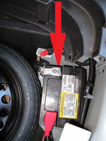

The 10 mm nut is simply loosened then you wiggle the battery cable off the post, you do not remove the bolt
