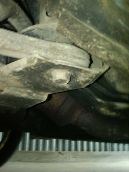

Here’s a closer shot, it has a 21 mm head, a 7/8 will work. If that’s the bolt proper torque is 74 ft lbs then turn it another 180 degrees.
