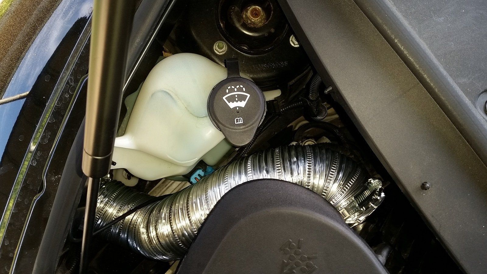

The air intake duct, commonly referred to as the woolly worm can be taped up, replaced with metal dryer vent flexible tubing . Part number Genuine GM 15865168 Air Intake Duct, Front be prepared for sticker shock they are expensive.
