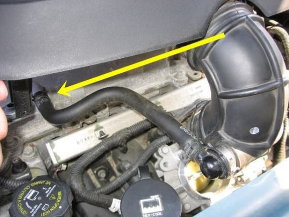

This hose, sometimes the throttle body end , that plastic round piece gets damaged. Note how the part of the hose parallel to the valve cover is turned up so oil flows back into the valve cover.
