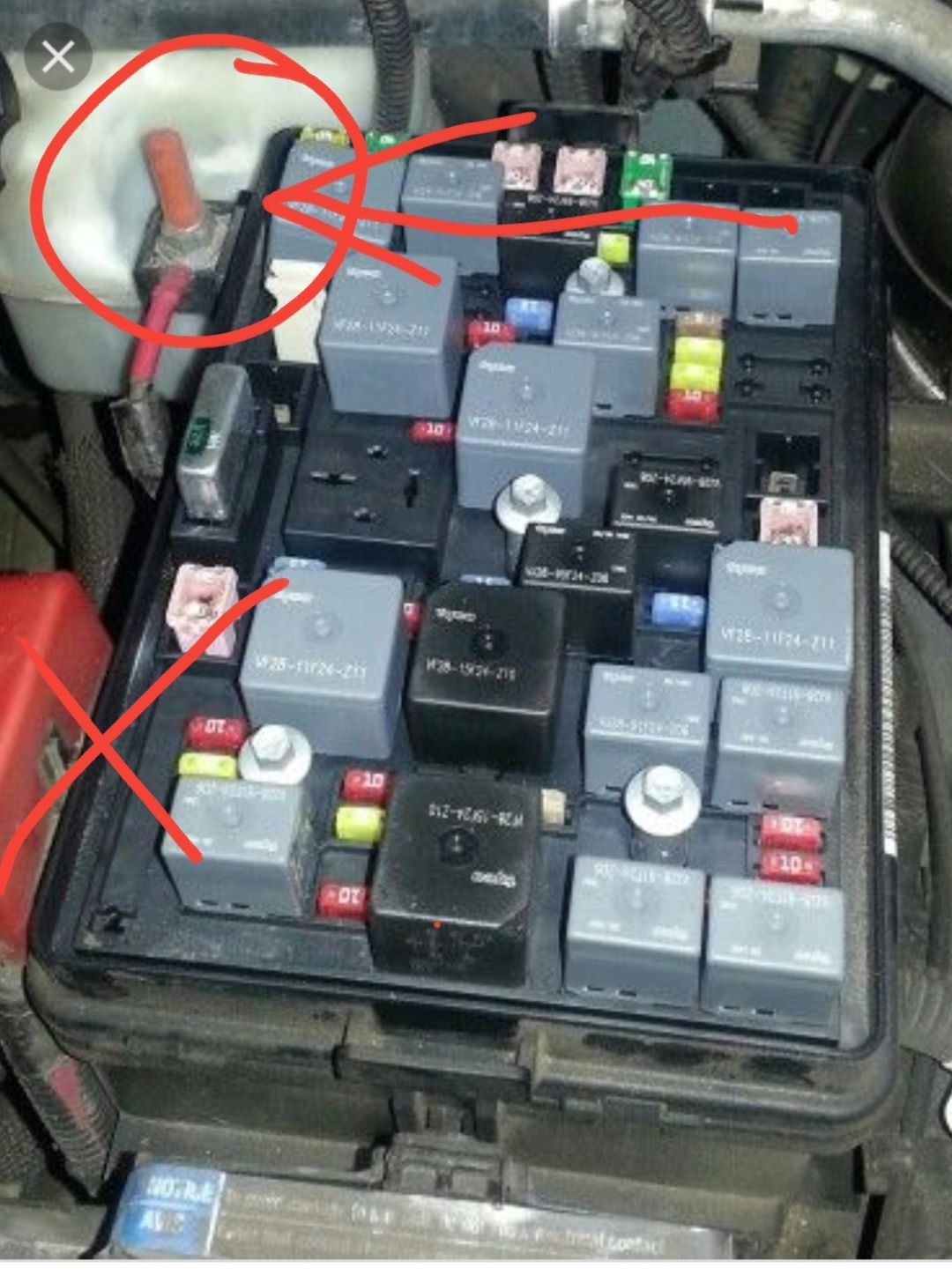

The circled red lug is the EPS power The X marks the battery cable to the fuse box then on to the starter
