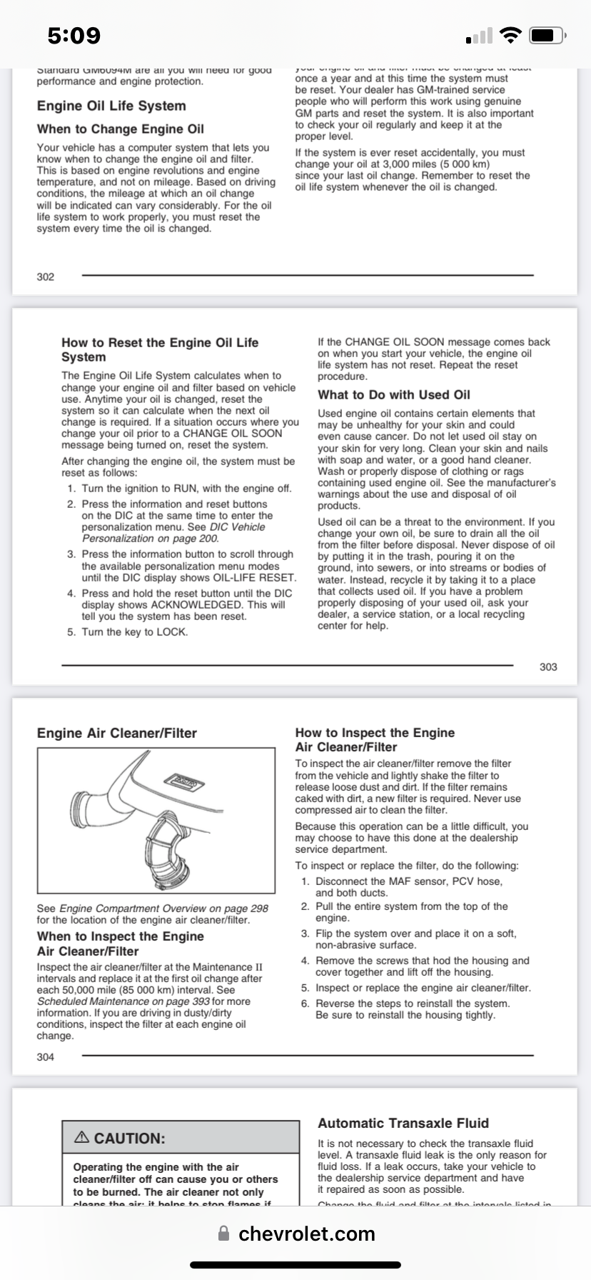

But I know I used the three press the throttle pedal method in Oldblue, every 10,000 kilometres, from 54,000 to 484,000 that’s 43 oil and filter changes! I wonder if someone with an ‘06 would try to reset with the three tap method?
