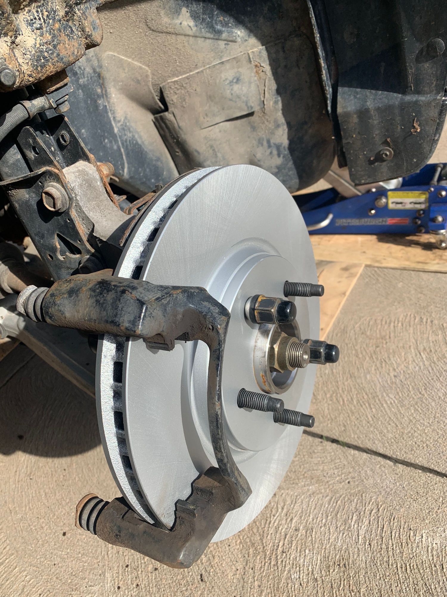

Brand new coated rotors to prevent rust , I torqued the caliper bracket bolts to 85 ft/lb and the caliper bolts to the sliders at 24 ft/lb . I made sure to pump the brake pedal several times to seat the pads to the rotors as I had retracted the caliper piston in so the new pads fit into the caliper.
