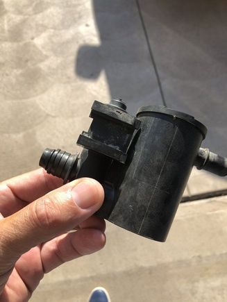

See the seal on the canister side (left) port above my thumb ? That usually gets tossed with the old part . Careful removing it , at this age it’ll be brittle.
