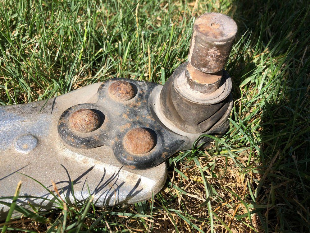

Take you angle grinder and grind these rivets on the ball joint side flat. Then centre punch them and drill 1/8 hole straight down they them , then 1/4 then 5/16. Drill the heads off with a 1/2 drill bit just until the head pops off Knock the ball joint off the lac and then drive the remaining part of the rivet out of the LCA.
