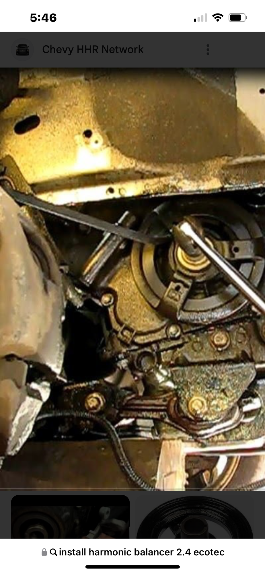

Oldblue December 12, 2024
I’m going to suggest just the pry bar to hold the crank from turning, you shouldn’t need the socket and breaker bar , these photos are from removing and replacing the harmonic balancer
