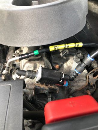

The line with the yellow label is the pressurized fuel line going to the injector log, the other line is the vapour line connecting to the Evap purge valve then to the intake manifold, no connection to the fuel of any kind.
