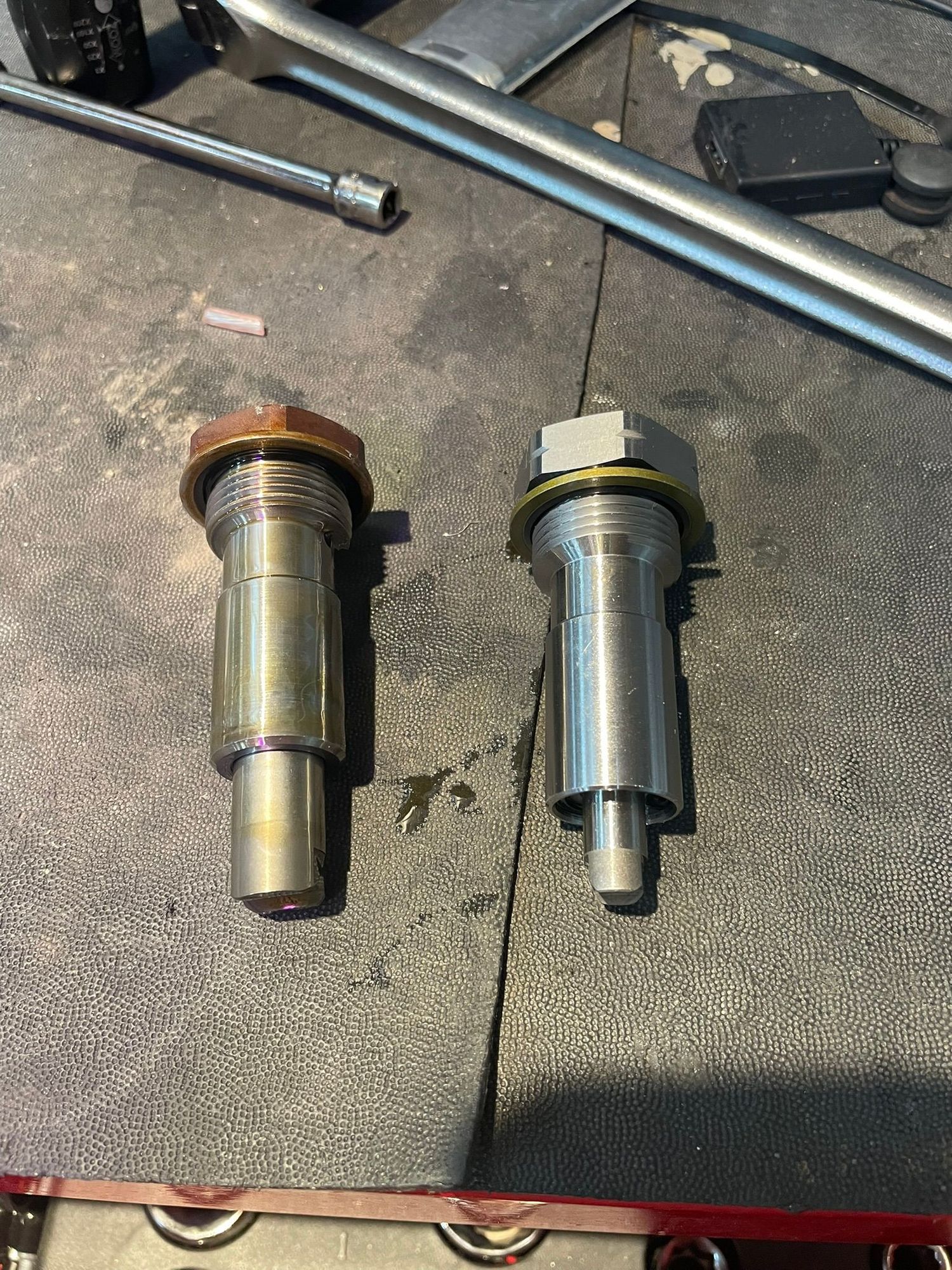

The defective OEM tensioner is on the left, the new is on the right. DO NOT activate before installing! It is normal for the shaft to slide in and out a few millimeters. The oil fill hole is near the washer.
