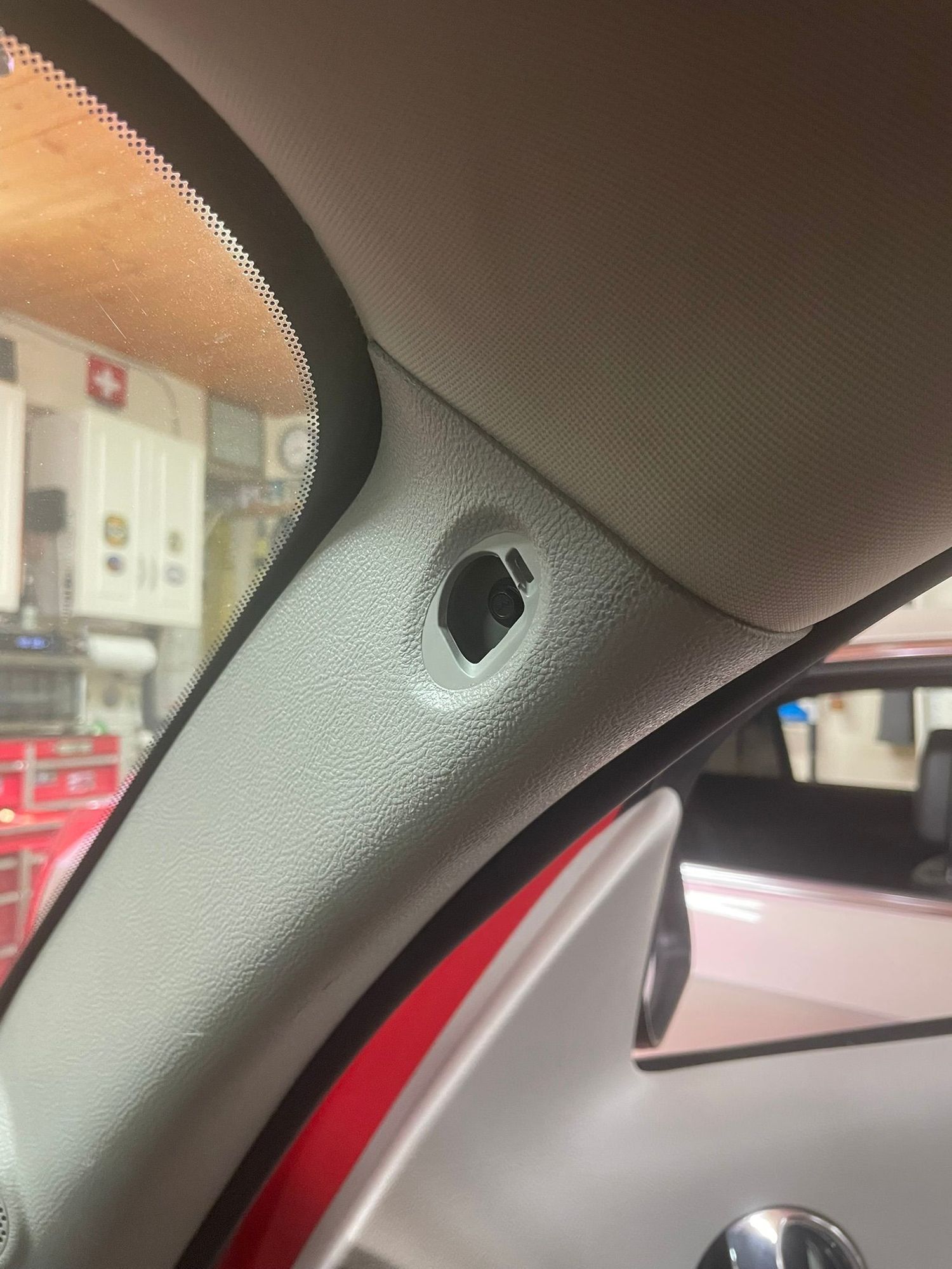

Remove the cap at the top of the pillar trim and remove the 7mm screw. The trim pulls up and out.
