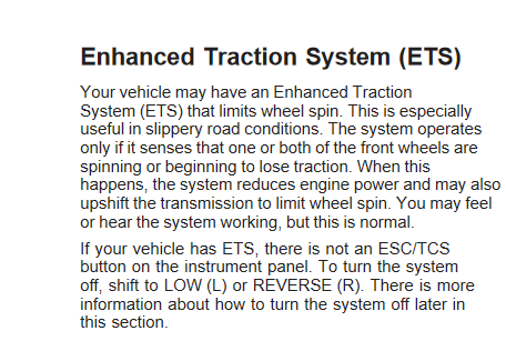

I just looked at the 2007 Owner Manual; there is no mention of a TC switch.
2007 does not have TC. It does have ETS. Read your Owner Manual pg. 246.
TC can control the brakes as well as the engine speed, ETS only controls the engine speed.
Why would you think it is a "bug" because you car is not equipped with something?
Here is an excerpt from the 2008 OM, it says basically the same as 2007. It tells how to turn it off.
That supports what Trex08 says about power train management only.
Might be a good idea to check for codes with an advanced scanner.

Codes for what? It is operating as designed. The Owner Manual tells how to turn it off, that is why no button.
