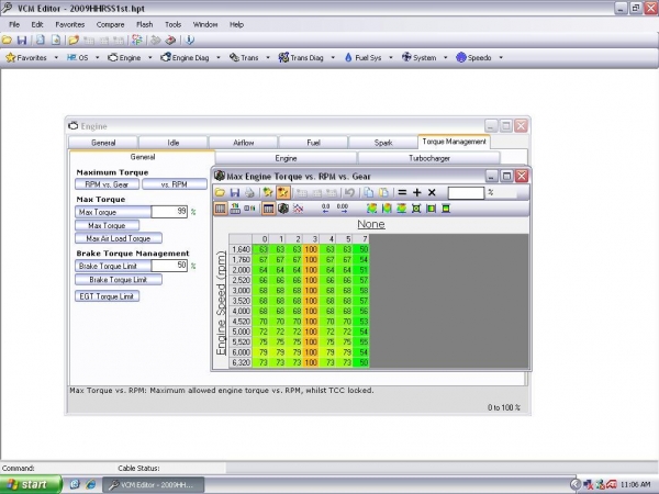

You can see that 100% of boost/torque/power, is available in one gear only...
Ony 63%-79% of boost/torque/power, is available, in all gears, but one...
There is NO other vehicle, that GM has has done this too, in history, but this is the only way, that GM was allowed, by engineering, to put an automatic, in our HHR SS 'buggys'.
That's why a 'tune', any 'tune', is the single most best improvement, that you can do to an automatic HHR SS 'buggy'...
Our 4T45E automatic, can handle more power, better than GM thought, that it could...
I've proved, after 6 seasons at the track, with 60' times in the 1.6s, & ETs in the 12.3s, that it can get the job done..
Here's another stock graph, of the pitiful , 'power-curve', that shows even more loss of boost/torque/power, on top of the reduction, in the 'gear' chart. Notice how the power, takes a 'dive', after 5,900 RPM
Combine the two, & your stock HHR SS automatic, is a slug…
