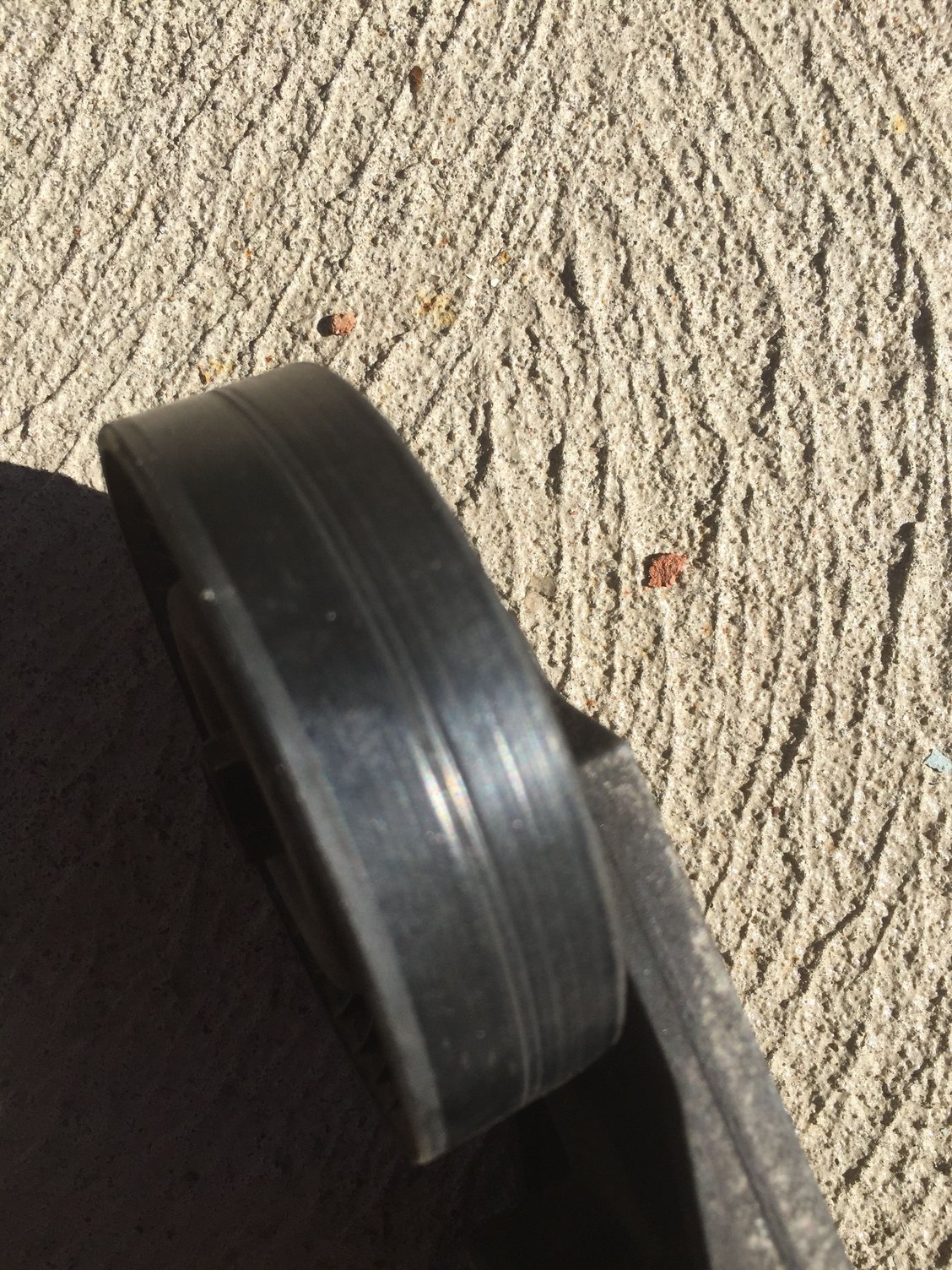

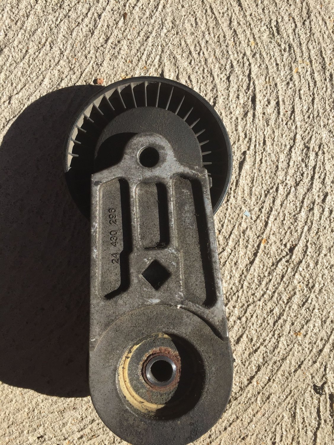

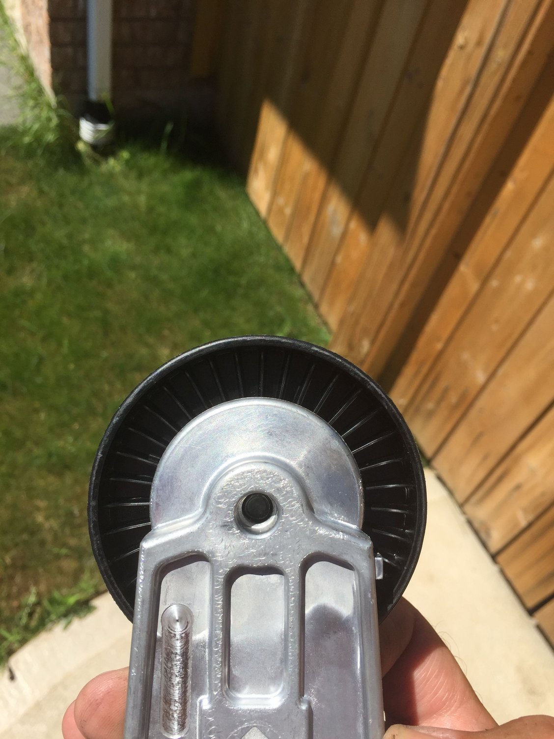

I just finished replacing the belt and tensioner, prybar on the jack and rereleased the pressure on the belt, removed the belt , lowered the jack.
Removed the bolt through the fender 15 mm, used a magnet to retrieve the bolt, wiggled the tensioner our the bottom, forward and down , reverse to install tensioner and belt.
I should have done this awhile ago, the idler pulley spins but is loose, now I know I could have just replace the belt and the belt, but after 11 years of service, I chose to just replace the tensioner
Nice new smooth pulley, the old one has a wear pattern and a ridge on it.
Clean new tensioner, so the spring is at full strength.
The new pulley , spins freely.
The engine side of the new tensioner
Here’s the old part....
Eleven years old, dirt built up
Dirt caked in the pulley
The belt wore into the pulley
