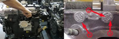

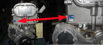

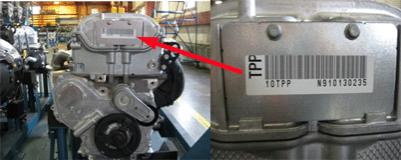

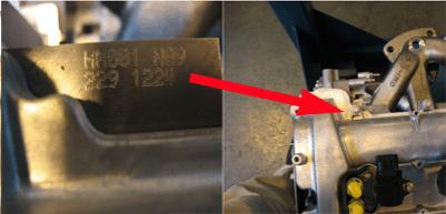

Pip4469G
#PIP4469G: Intermittent DTC P0011 P0014 P0016 P0017 Or Hesitation / Stall - (Nov 3, 2009)
Subject: Intermittent DTC P0011, P0014, P0016, P0017 or Hesitation/Stall
Models: 2009-2010 Chevrolet Cobalt
With RPO LAP 2.2L, LNF 2.0L
2009-2010 Chevrolet HHR
With RPO LNF 2.0L, LE8 2.2L, LE9 2.4L
2009-2010 Pontiac G5
With RPO LAP 2.2L
2009-2010 Chevrolet Malibu
2009-2010 Pontiac G6
2009 Pontiac Solstice
2009 Saturn Sky
2009 Saturn Aura
2009 Saturn Vue
With RPO LE5 2.4L
2009 Saturn AURA Hybrid
2009 Saturn VUE Hybrid
2009-2010 Chevrolet Malibu Hybrid
With RPO LAT 2.4L
2010 Buick LaCrosse
2010 Chevrolet Equinox
2010 GMC Terrain
With RPO LAF 2.4L SIDI
For engines built prior to the following breakpoints:
Block Machining debris breakpoint is August 20th for all engines built in Springhill Tn. (Plant code T)
Head Casting sand breakpoint is September 2nd for all Ecotec Plants.
ADD APPROXIMATLEY 2 WEEKS FOR VEHICLE MANUFACTURING
The following diagnosis might be helpful if the vehicle exhibits the symptom(s) described in this PI.
Condition/Concern:
In rare instances a technician may comment that they find DTC's for cam phaser operation and/or have noticed a hesitation/stumble or, even more rarely, a low RPM (idle) stall (typically on a PDI or with very low mileage). They have followed eSI diagnostics and they find one or more of the DTCs listed below.
P0011-Intake Camshaft Position (CMP) System Performance
P0014-Exhaust Camshaft Position (CMP) System Performance
P0016-Crankshaft Position - Intake Camshaft Position Not Plausible
P0017-Crankshaft Position - Exhaust Camshaft Position Not Plausible
Recommendation/Instructions:
Note: Please document on the repair order the type of debris found (i.e. sand or aluminum). When debris is found change the oil and filter before returning to service, in some instances it may be necessary to change the oil and filter multiple times. The filter can be inspected afterwards to ensure no additional debris is present.
Engineering has determined that casting sand and or non-ferrous (aluminum) machining debris in the camshaft phasers/solenoid valves can cause a hesitation/stumble and or these DTCs to set intermittently. This concern typically will occur very early in the vehicle's life or at PDI. When the technician has followed the eSI diagnostic chart for these codes they may be led to ECM replacement; however additional diagnostics should be made before replacement of any parts. When the inspection of the CMP solenoids/actuators and wiring confirms correct electrical operation, check for debris. The recommendations listed below should help.
ENGINEERING HAS REQUESTED WE COLLECT ADDITIONAL INFORMATION. PLEASE FOLLOW THE STEPS LISTED BELOW FOR YOUR APPROPRIATE ENGINE.
FOR RPO LAF 2.4L SIDI ENGINES ONLY (EQUINOX / TERRAIN / LACROSSE) BUILT AFTER 90902 (2009/SEPTEMBER 2ND)
To determine the build date of the engine, look on the sticker/tag on the accessory belt end of the cam cover. Look for the numbers on the right hand side starting with the letter N. The first 5 digits after the N will determine the build date.

To determine the build date of the engine look on the sticker/tag on the accessory belt end of the cam cover. Look for the numbers on the right hand side starting with the letter N. The first 5 digits after the N will determine the build date. This number is also etched into a pad on the oil filter housing.
To locate the cylinder head casting date remove the air duct and engine beauty cover. Just below the cam cover and just to the left of the high pressure fuel pump are two bosses with numbers on them. The number on the left boss is the year (09) (See call out #1) and the number on the right boss is the production week (See call out #2). The number on the right boss is inside a circle with 7 wedges around it, if possible count the number of wedges (See call out #3) that have bumps in them. This corresponds to the day of the week.
To locate the cylinder head machining date look at the front of the engine (accessory belt end). Located on a horizontal machined surface on the rear of the head (toward the cowl) are two lines of letters and numbers etched into the cylinder head. Record the 2nd line (all number with 7 digits total) closest to the cam cover.
Inspect for a process paint mark on the cylinder head: The paint mark will be on the front (accessory belt end) vertical face of the cylinder head in a small rectangular depression in the head casting just above the engine block on the left side. Note on the RO if there is any type of paint mark in this depression or if it's bare aluminum.
