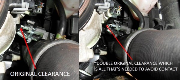

I know the feeling. Last year, after many visits to address a boost problem, the dealer FINALLY fix it (they found loose connection causing a boost leak), and the fix lasted for about 5,000 miles. The car recently lost boost and no power while on the freeway and throwing P0101 and P0106 codes. So, I figured it was time to solder the lower MAP sensor wires. So, I did that given I'm now out of warranty. For a little insurance, I moved the lower IC pipe farther away from the AC compressor, and installed the TTR motor mount.
The car has been running great and easily producing GMTU-level boost until this afternoon. I was slowly pulling away from a signal light when the engine felt like it died. It didn't die, but it had very little power but no engine light. I was eventually able to drive it home. It got a pending P0101 code.
So, here I go again. Although, I really enjoy the car when it works right, I wish the car never had the GMTU...

You have to hold the pipe away, sounds like yours hit it again. I think a new wireing harness and a reflash will take you back to perfect stock. Dealer told me 300.00 labor to do it.
Wish I had a answer for you Big Jack, I hope Jessica will be able to get more attention on it. You go girl......
Here is one way to do it rlee63a4

SS fan, I'd like to think that's not the problem since I about doubled the clearance between the sensor/wiring and the AC compressor by moving the cold side pipe farther forward, and I installed the TTR motor mount to reduce the amount to engine movement. Whatever's going on at the moment is intermittent. The car drove as it should yesterday evening after a cursory physical check of the pipes for any obvious cracks/splits/leaks. I plan to check for a boost leak this weekend.

My lower tmap has probably 4 times the clearance than necessary since I did the 180 degree flip actually its impossible to be hit there is so much room.
