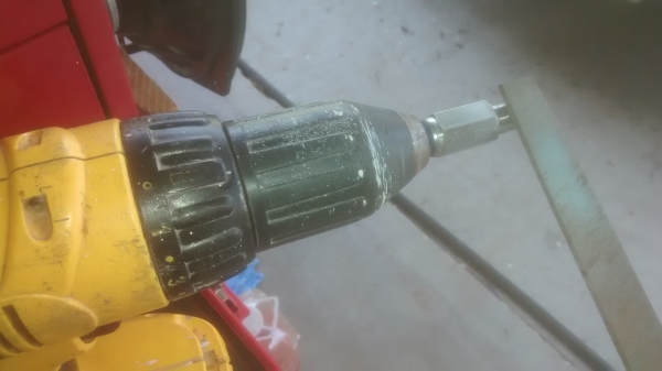

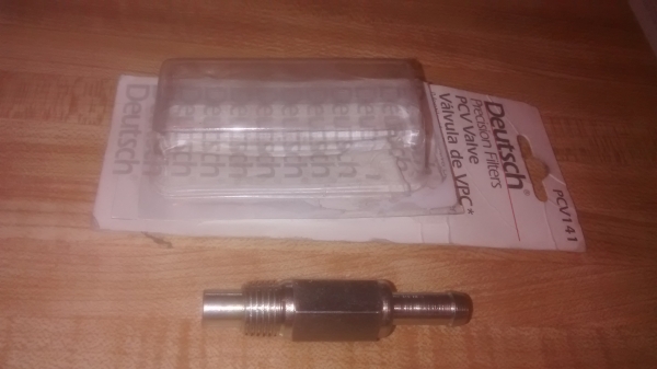

I found a PCV valve that I like for use as a check valve, PCV141, under $5 at AZ.
It required some modification(grinding off the threads) to fit my 11/32 hose on it. I did most of the grinding with the bench grinder, frequently cooling it with water, then chucked it into my cordless drill and filed the rest.
Here is the routing for when I begin phase 2 (1 catch can, vacuums teed together with the check valve).
Phase 3 will be simply switching to the other vapor draw point.
