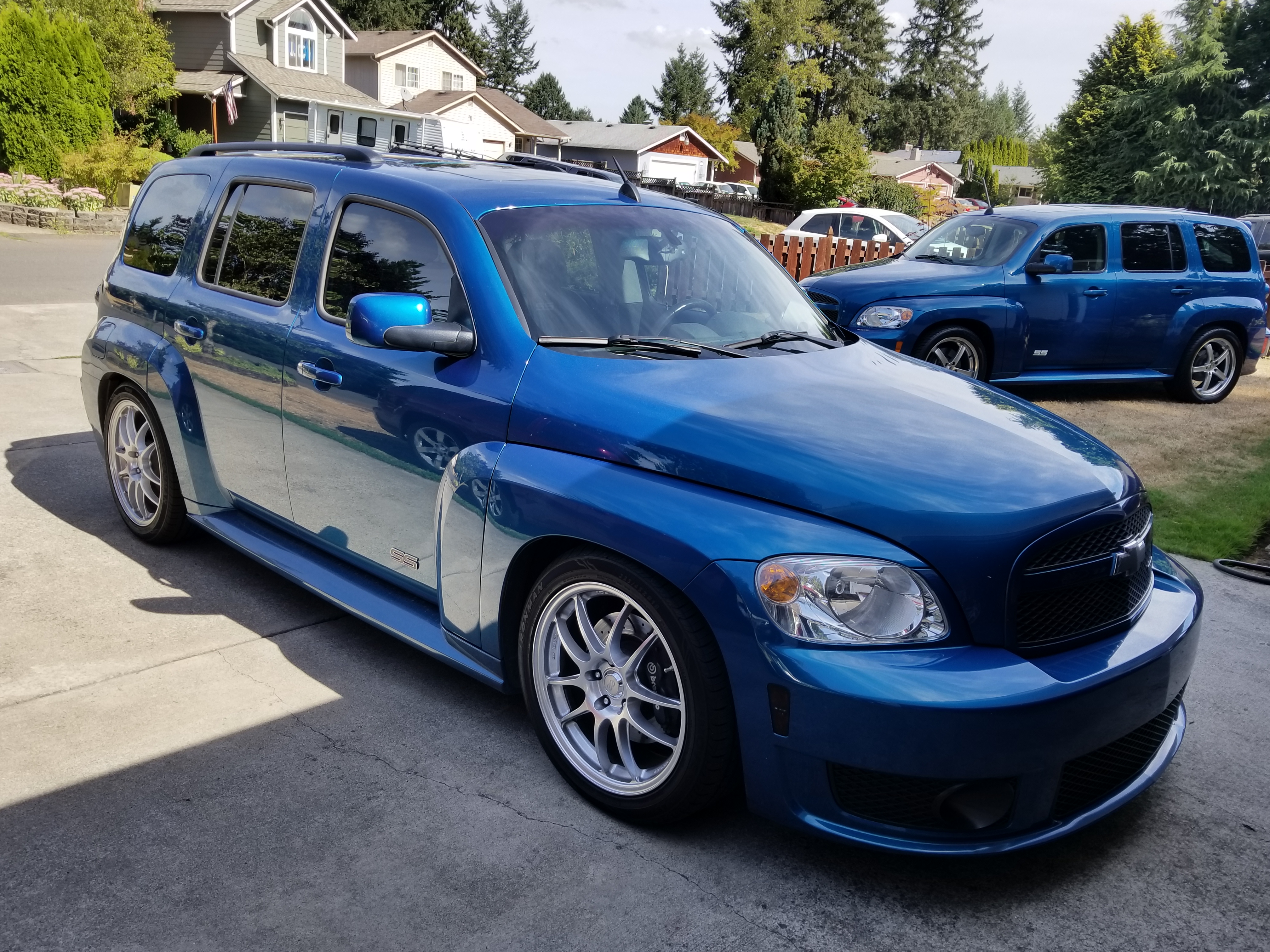

I installed the pipe only, way back when. My Daughters car now, still tickled pink I took Daves advice, gut the second cat for the full "Dave" effect
I have done the k&n on the next 3 hhrs, tube&filter only on the SS's works fine.
Thanks again Dave.........it's an auto she likes to leave the boys wondering ??
Attached Thumbnails It's amazing, that a piece of plastic tubing, can make such a big difference...-20170910_123208.jpg
