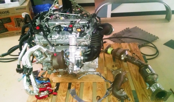

Look what jumped in my truck and followed me home
I wasn't looking for another project but I couldn't pass this up. I'm gonna have to drop my motor and trans to replace the clutch, half shafts, add the 5th injector, develop a good LNF oil separator....
I was told that this engine had not seen any road miles, by looking at the clutch and flywheel and a number of other items TI tend to agree with it. Heck the factory marking paint marks aren't even burned off yet.

Sunday was spent getting the motor up on the engine stand and removing everything. Essentially I have an LNF long block on the stand now. This motor had no real run time on it. Intake ports have no oil and/or coking heck the oil I drained out was the factory fill. The inlet on the turbo did have oil misting in it that was easily wiped off. After removing the valve cover I have figured out how to make an oil separator/s for our combination. I'll pass that on after I design and built one. I'm going to go a different route from what others have developed, mine will require removing the intake to plug a hole so the factory PCV can be moved to a new location. As they say, film at 11.
Only thing I had issues with was those SS lines running from the valve cover to the inlet pipe ahead of the turbo and the line that runs from the valve cover to the inlet of the turbo...... can't get the tool in that releases those clips.... what were they (GM) thinking....... I destroyed the one line trying to get it off.... price of progress I suppose. I'm going to remove those fittings from the valve cover and machine JIC/SAE/AN fitting that will press into the valve cover. The factory fitting are pressed/interference type fitting, I will make fitting that will replace them.
