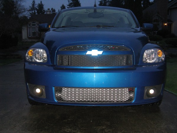

Just installed the crazy steve's intercooler....it was a pretty tight fit.....but I managed to get it in! Love the looks of it front the front
Old Nov 9, 2011 | 08:24 AM
Pretty tight is right. I just changed the angle on the left side of radiator, cm's to spare, 1 or 2 of them anyway.
