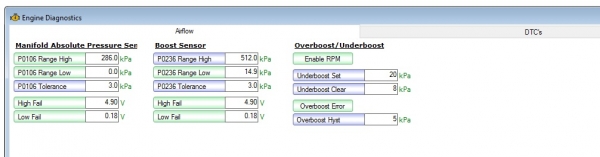

Need to apologize for my somewhat snarky reply yesterday. When I seen the original post and the replies going back and forth I was busy working on something at work and hastily replied. After all we are all here to learn and my reply was a little over the edge after I thought about it.
So with that said I'm assuming you have HPTuners if you loaded the tune. Open VCM editor and then your open your stock file and then go to the top bar under Compare then "Open Compare File" and select E47 file you have. Then select Engine icon and the General tab. You will see MAP look at the values in MAP Sensor Linear and MAP Sensor Offset between the two files. That is where you would scale the MAP sensor. 2 bar sensor would have a value of 55.68 kPa in the MAP Sensor Linear Box and a value of -1.70 kPa in the MAP Sensor Offset box whereas a 3 bar sensor would have a value of 65.89 kPa in the Map Sensor Linear box and a value of -6.35 kPa in the Map Sensor Offset box. You would also need to change some values in the Engine Diagnostics Airflow tab that are different from one sensor to the other. i.e. P0106 Range, High and Low.... there are more. This is a readers digest condensed version of a couple of parameters that need to be changed to upgrade from a 2 bar sensor to a 3 bar sensor.

Also wanted to add another note. In HPT VCM Editor in the Compare tab you can select Comparison Log - Differences and see what has different between the 2 files to get an understanding of what needs to be or has been changed between the 2 files.

If you have a tuner that you are using I would have him make the changes he should know what the difference are between the 2 files and what needs to be done. He and you will have the files licensed/credits applied for your packages anyone else would have to apply there credits to make make any changes and save the file.
Here is a brief list:
Airflow.
General
MAP Map Sensor Linear, Map Sensor Offset
SC/TC Boost Sensor, Boost Sensor Linear, Boost Sensor Offset
Engine Diagnostics
Airflow
Manifold Absolute Pressure Sensor
Boost Sensor
Overboost/Underboost
Look at the differences between the 2 files to get an idea where you need to go.
