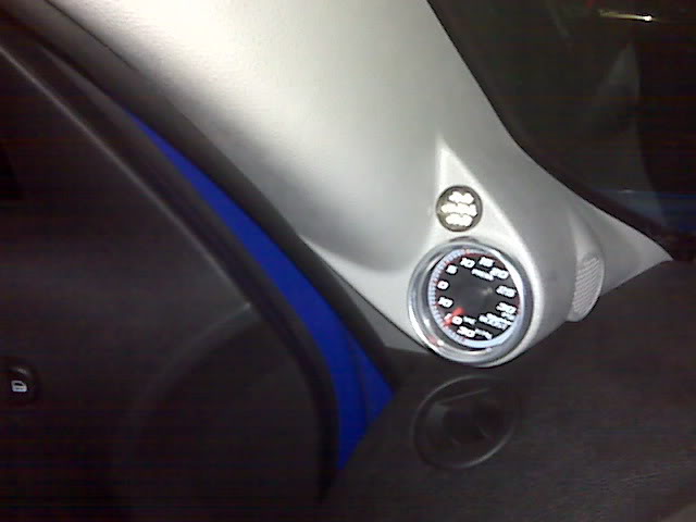

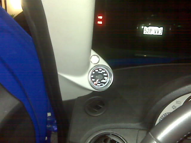

I lied. Here are some crap cell phone pics, but at least you can see the fitment. It's NICE. If I didn't already have this one, I would have gotten one with a silver housing to put in this location so it matched the gauge better. I got the black because this used to be mounted in an air vent in my Sentra. It was a great conversation peice when starting up the car on a date. LOL!

That fits nicely. How hard is it to install?
I pulled off the pillar, marked exactly where I wanted the light to stick through, drilled the hole, sanded the edges, and wrapped the end of the light with a little electrical tape to make it fit nice and snug. The electrical tape is imperceptible. The included bracket was too big to screw it into the gauge pod, but the thing is so light that I just used double-stick tape on the inside. I still don't know where I'm gonna tap into tach signal because I don't wanna have to go through the firewall, but other than that the only wiring is power and ground. On the shift light you have to flip two switches according to the manual to set it up for the number of cylinders, then turn two little dials to change the setpoint in 100rpm increments. That's it.
