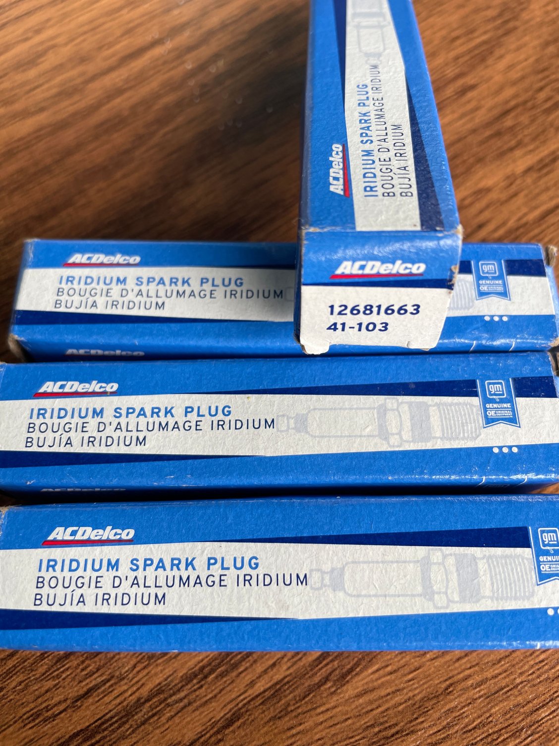

Looks like some time has passed since this thread was touched. There’s a bit of variance in thought process here, and I’d like to revisit this, and see what the consensus is on the gapping.
I just got the correct ones, and since the Iridium NGKs now have about 50k on them from the replacement date, I think it’s a good opportunity to replace them with the correct brand.
Napa gave me .040 as the gap, AutoZone gave me .042, and the threads here have a whole bunch of numbers 🤔
Has anyone figured out what the best gapping is for 2.2L ?
