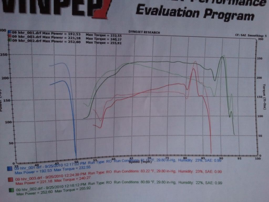

So out of curiosity I put my '09 SS auto on the dyno, it only had about 1,000 miles. This is stock vs. my custom tune, still on a 2.5 bar map setup, on an inertia dyno with no fan. Just thought I'd share the info, not sure how many autos get dyno'd on here

I couldn't lock it in gear with the beta software I used, so it shifted. This basically means you have to look at the lines instead of going by the posted numbers, but roughly 180 stock and 240 tuned. I think a fan would have helped since this thing heats the air so bad, but all in all not bad for the lil' guy.

Meant to add, although there isn't a true RPM base, where the lines cross is 5,252 RPM, stock shifted at stock 6,150, and tuned I set it at 7,000 just to see where power fell off at on the dyno. You can also see the boost cut right before it shifts.

Are you experimenting? The stock HP for the SS is 249 or close to that.

To the wheels?

That is a bone stock HHR SS with no mods.
Maybe we can convince Rainman to post up his dyno charts or I can request them from Vince when he is done next week. This will show us to the wheels. Rainman does have some mods done to his HHR ans lives close to Vince.
