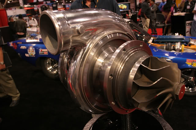

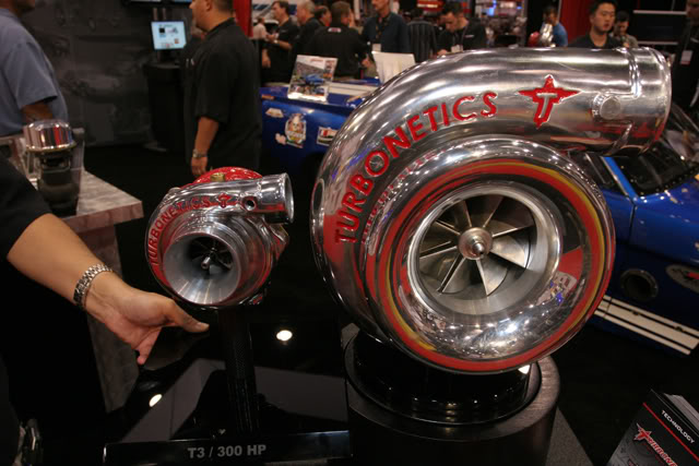

Turbonetics billet 122mm capable of 2500hp and 60psi
WIN!
