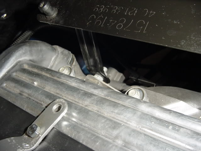

I think everyone is familar with twisting off the oil filler extention after installing the CGS (or Airaid). CJ mentioned removing the factory air box bracket a few weeks ago and I got around to removing it today.

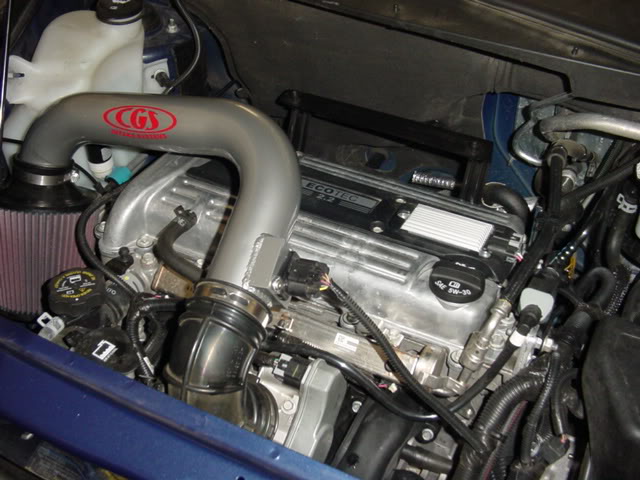

This is with the CGS and the factory bracket which sits just behind the valve cover.

It is held on with two 13MM bolts, lean over the motor and they are easy to spot.

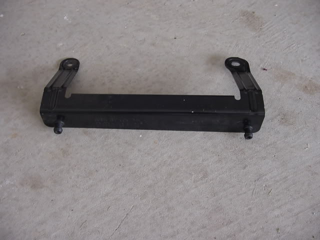

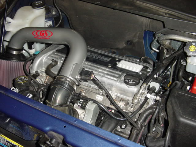

After the bracket is removed.

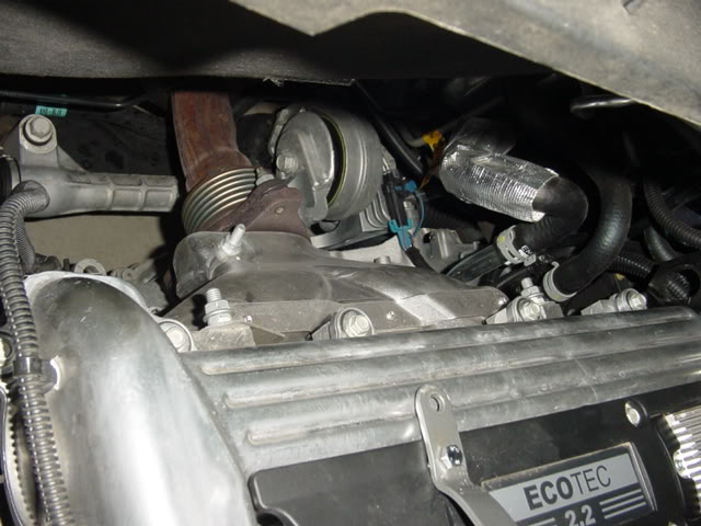

And here's all the space left over behind the motor without the factory air box bracket. Looks like plenty of space for a turbo.

I now have a spare bracket for sale....anyone...
