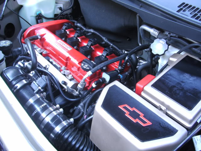

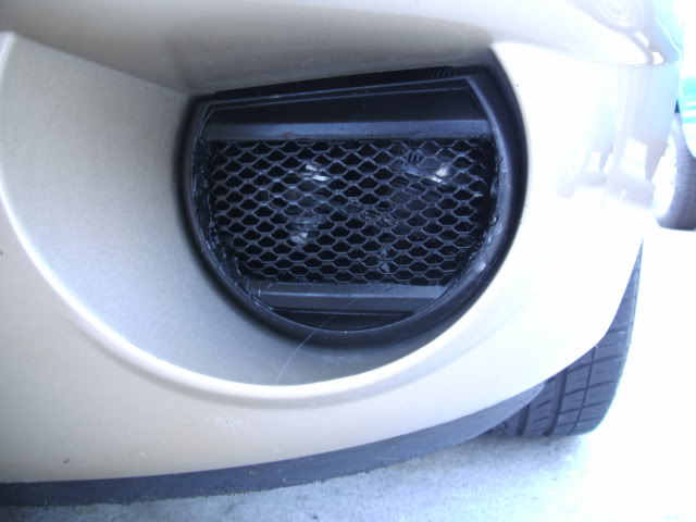

I just used a piece of 2.5" pipe with a GM MAF sensor mount for mine and it works like a charm. I then got the Scoche 2.5" to 3" adapter to run the 3" pipe down behind the headlight.

2 Attachment(s)
Sounds like mine,great intake for not much money:thumb:Attachment 26878
Attachment 26879

Just wondering how that works in high water? Hydraulicing (sp?) a motor can be real expensive...
No problem,the filter is up behind the headlight. The filter would have to be submerged to hydro lock the motor.Been running with this set up for awhile now and thru several heavy rain storms,worked just fine.

this is pretty simple and gets the job done... I done this in the past with hondas i owned.

I got it to work thanks for the pictures it looks great. I had to cut off the stock MAF tube off the stock box as wheel. Im thinging of putting a hood scoop on with a big CAI filter running to it.
