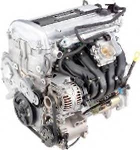

can anyone tell me or post a pic on how or where the spark-plugs are ? just got an HHR LS 2.2L
Old Jun 30, 2012 | 11:58 PM
Spark plugs are located on top of the motor (under the air filter box)..
Pic is of a 2.2 L61 (which also has a cover over the plugs)
If you don't have many miles on yours, why bother ?
