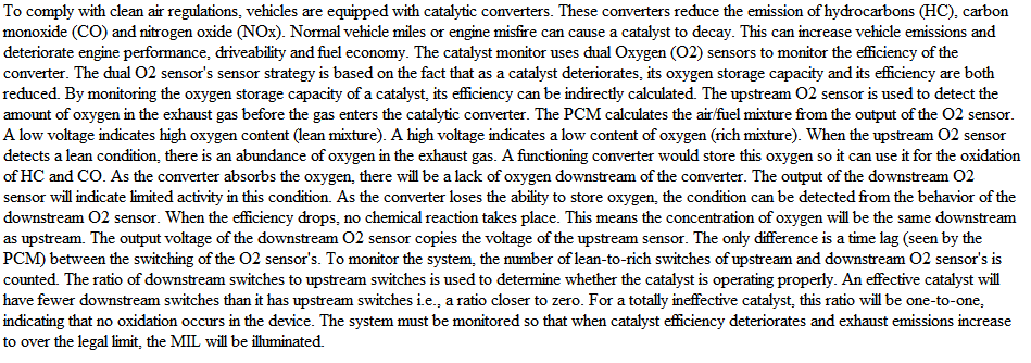

Here is a fairly easy to understand description of what the PCM is using to throw a P0420.
Without a good graphing oscilloscope you can't see what the computer sees. I tried.
