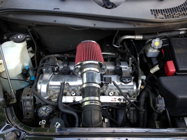

Ok Revision 3 less induction noise more throttle response no Codes being thrown
I also installed a chime retainer that sounds to me much better that the stock noises less annoying

OK i found it 9405 kit and the way you setup is know the way i go .also what size is inlet cone 3"or 4"
Old Jul 21, 2014 | 11:18 PM
Posts: 11,718
The title of this thread says, Cold Air Intake. Sorry, but what I see is an open filter sucking in hot engine compartment air.

its a work in progress George,
Hurst, the rubber OEM elbow is 2.5" the spectre is 3" but with the 2.5" insert

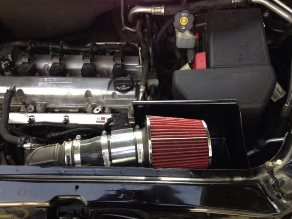

Revision 4 moved the filter away from the cam cover and heat and built a box arround it

It's all trial and error...the fact of the matter is that any intake without a tune is just there for sound and looks. I think it looked better over the valve cover...as firemangeorge pointed it...it's not really a cold air intake...even the way you have it now with the box it's not a cold air intake.

Ive got a trifecta tune lined up with a local guy, he seems to know what its all about, this current revision has been the best and seems to run great, wanted to get rid of the large plastic air box and the horrible pain in the but air filter, at this im happy and on a normally aspirated car the pipe will help but isn't apparently necessary for the tune.
