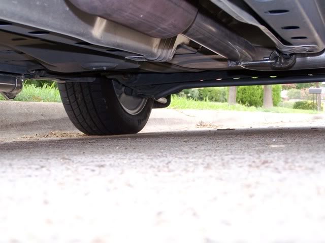

pics

it was 2.25 in pipe coming out of the manifold to the Cat. The cat had a reducer on it to 2" on the other end.
the section after the cat had the O2 sensor on it and it was 2" to the resonator. i could have kept it at 2" and saved some cash because of adding the new O2 mount. so that is something that can be done. i wanted it to be true 2.25.
the resonator was 2 and they cut it right at the opening and swedged it to 2.25 on both ends. they also welded right to the outside of it so it stayed 2.25. Not much resistance but lil help on keeping it quiet. he said if i wanted it off come back and they would just do it for the price i paid.
it was cool watching them take the longest last piece and copy it w the bender. really awesome. the T924 is already 2.25 so all they did was cut the reducer off from before and had the 2.25 inlet already there.
i dont know how much louder it would be w/o the resonator and i was thinking after i should have let them hook it up both ways and listened to each.
i am very happy w the way it is running and sounding. nice really low hum and the nice thing is it isnt much louder w your foot in it.

Cool looking photos CJ. Sounds like you're really pleased with the results.

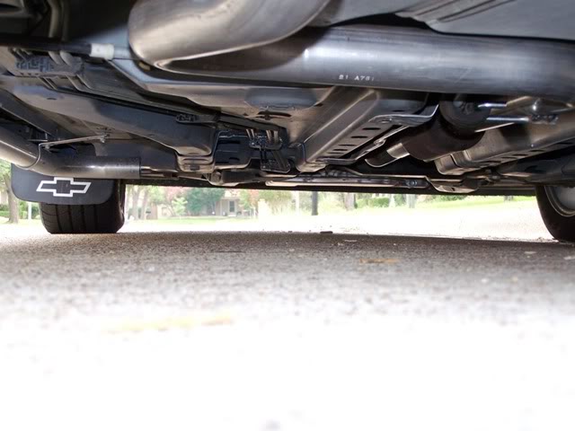

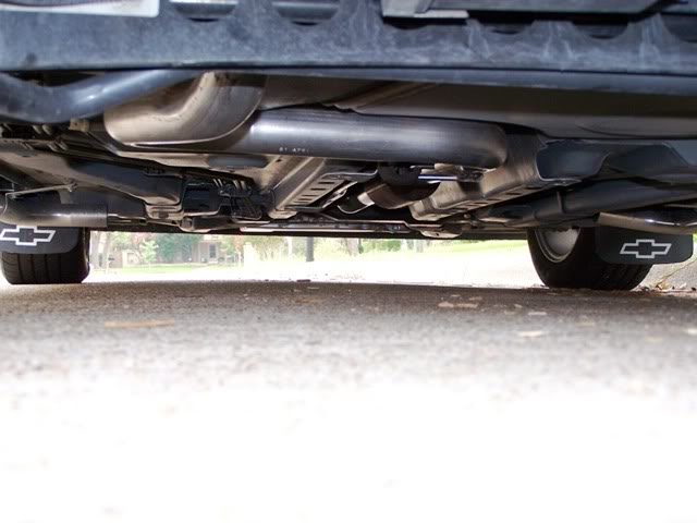

new pics

Great pix CJ!
Those boys did a great job on the welds and bends
