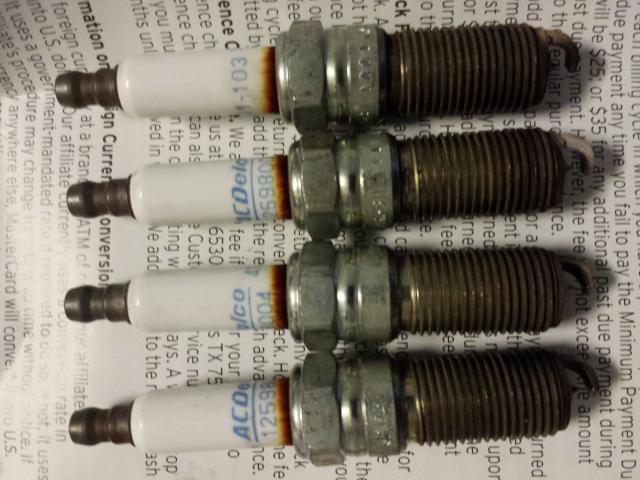

I actually had my spark plugs changed this morning at 103000 miles and this is what the old one's looked like. Keep in mind i just changed my plugs because i knew it was time not because of any performance problem. I am getting about 28mpg consistently. I did my plugs, air filter, some fuel system treatment, i wonder if my mileage is going to even get better. They look pretty scary too me.

Maybe Im old school but I still cannot believe a plug last 100,000 miles.
