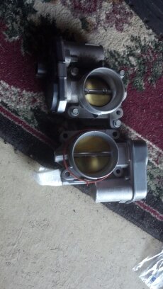

Mounted the blower and installed the new throttlebody
The top TB is stock for 2.2 and the other one is the lsj throttlebody. The lsj is noticeably bigger.
