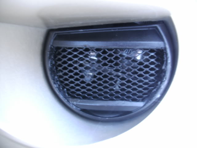

Followed CJ and Joe R's idea and drew cold air from the space behind the H/L,made a world of difference even w/o a S/C as far as intake temp..........3 deg. between air temp. and intake temp.

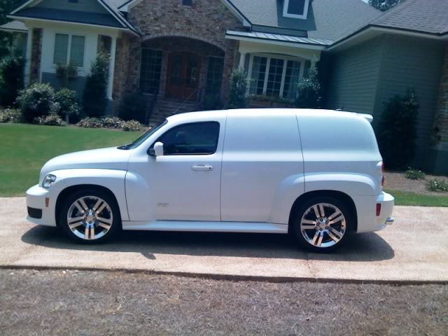

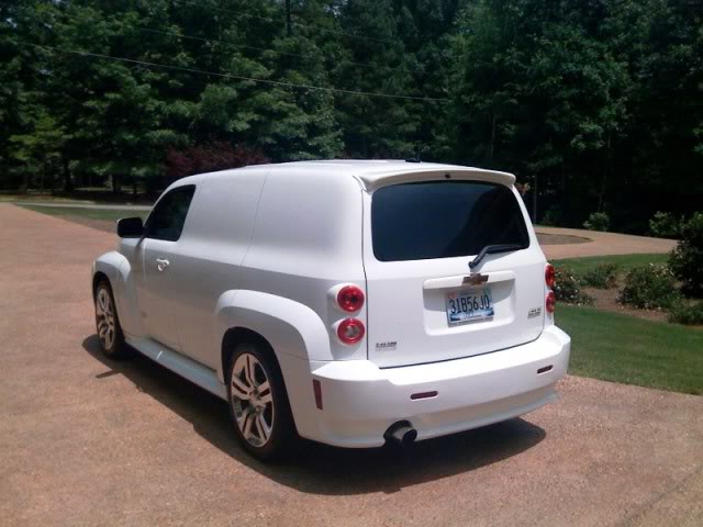

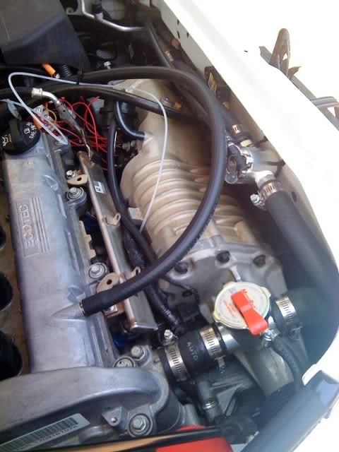

he put a front and rear bumper and front hood and the sides off of a wrecked SS

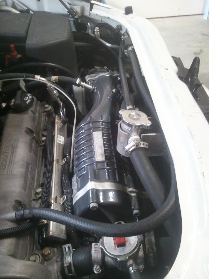

This started out as a 2.2 panel that Glen put a S/C on it
he had already added the 2nd seat and then added the SS *front bumper, grille, side rails and rear bumper and spoiler making it a white SS panel
only one of its kind
he then added a twin spool s/c, has wiseco piston 10:1 , eagle rods , worked head TVS with a 2.5 pulley meth with a 14 nozzle.
custom exhaust too

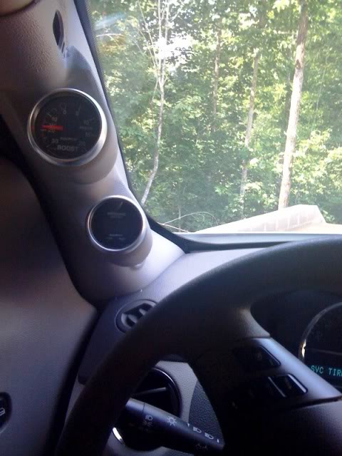

custom 2 gauge pod on left
