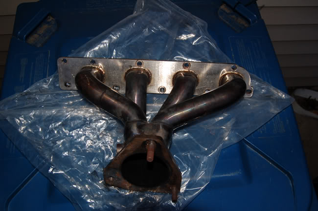

And if you don't already have one, add a Header.

Maybe 10 with the header?

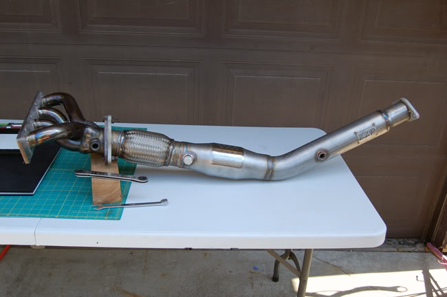

I have to Pass Emissions testing here so I went to the high flo catted down pipe.

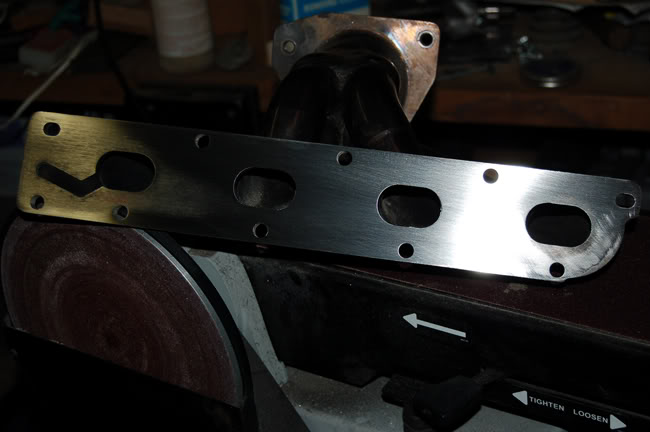

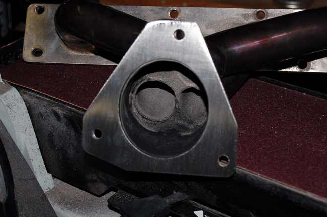

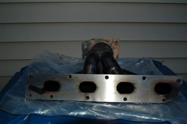

I resurfaced the flange on my Delta Stationary Belt / Dist sander and it's good as new.
I think the guy I got it from had a exhaust leak and decided to buy yet another header instead of a 10 minute resurfacing job. I don't think he knew they could be resurfaced to reflatten the flange.

Took me maybe 10-15 minutes per side on my stationary belt sander to correct it.
