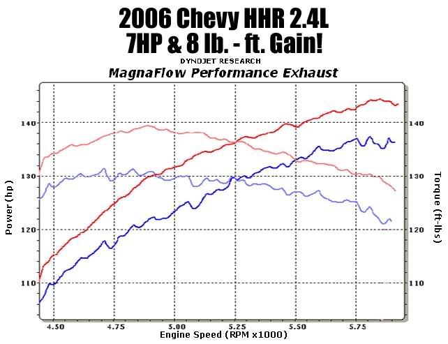

Using the 2.4 HHR and the Magnaflow catback as an example the tubing is increased to 2 1/2" diameter. It netted 7 HP and 8 lb.-ft. of dyno proven torque:
They increased the diameter of the tube and didn't lose power and torque, it did the exact opposite and I'm sure it doesn't run like a**. By swapping the muffler alone what do you gain? Maybe 2 or 3 HP? Nothing you'll notice or feel! Please have a clue before making comments!

I have the same muffler as Kenny and there is a "noticeable" improvement off the line. My HHR "burns out" more than before. the engine "breathes" better too, you can feel that it is more open and less restrictive than stock.
Regarding the MagnaFlow: Sounds like white rice. VERY Loud. Way too ricey for me. Also, we found during testing for the AEM intake that the HHR likes "higher velocity" runners on the intake - I'm betting it likes the same in exhuast. 2-1/4 is MORE than enough for this engine - it's only a 2.4L 4-banger!
I will have official dyno numbers of my HHR with muffler sometime next week - that should clear up the actual figures once and for all. I'm still betting it's 5-7hp gain.

How are you going to base line your HHR if the exhaust is already on the vehicle? You would have to run it with the stock exhaust on first in order to give the charts any validity. You should know that. Even if you base line another similarly equiped HHR there is still variation in stock engine figures so there is the posibilty that it wouldn't be the same as your HHR.

My HHR was already baselined "stock" at AEM before we did any intake testing. Gotcha!
