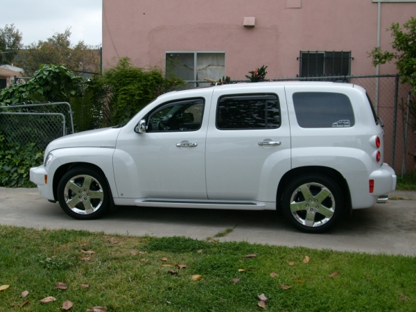

B4 and After

Looks Great Don!
It is a pretty easy job isnt it?

Looks great! If you only lowered the back? Your headlights will need to be readjusted though. Looks sweet! Todd (Uma)

Headlight Aiming Page 5-38 in owner Manual. Real easy also, and you will see better
