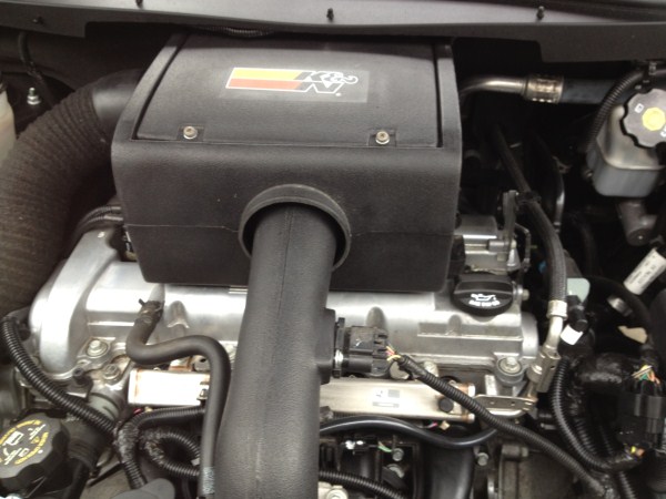

Air intakes are one of the first things most do, easy to swap and not too expensive. Plus you get to SEE your motor.
But, Performance wise, not much bang for your buck really. You can hear your motor at WOT, some mistake that as performance gains.
I have several the K&N, CGS and the GMPP. Currently running the GMPP for Looks.

I'm knowledgeable in body work but clueless on everything else. Bear with me please.
I'm seeing this for a air intake, ugly and somewhat expensive for what it is.
http://www.knfilters.com/search/prod...x?Prod=57-3056
Any other suggestions?

They work pretty good on a SS also. It is a new program for the computers, ecm and tcm, just tells your car to run better.
I got mine from a non supporting vender, actually got three of them from Him.
Thats the intake I have.
Thanks to the two others for their advice, but a special thanks to American & Proud for this detailed reply.
