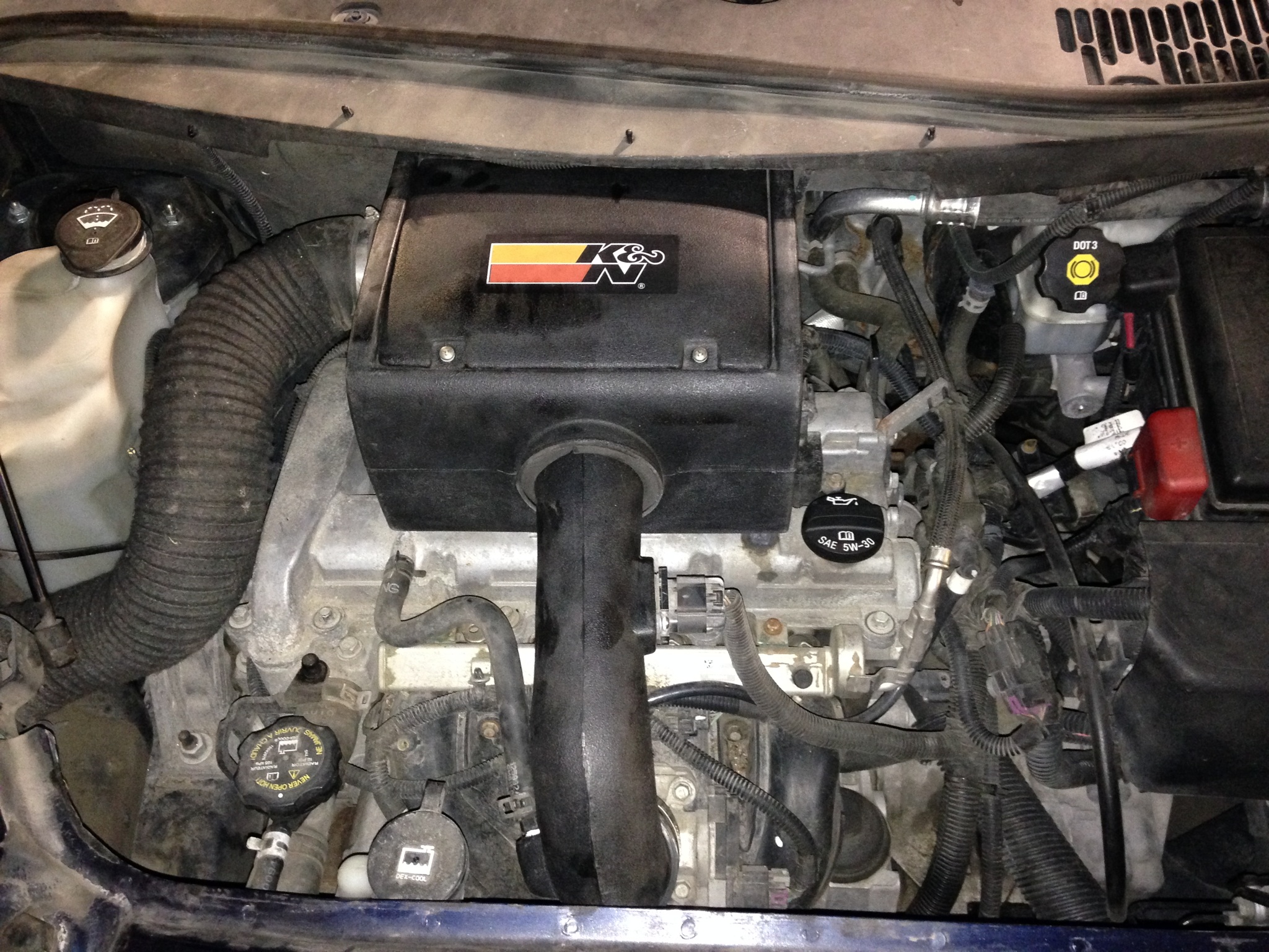

While you have your hands dirty, check the hose from the valve cover to the elbow at the throttle body for oil and oil being sucked into the throttle body
