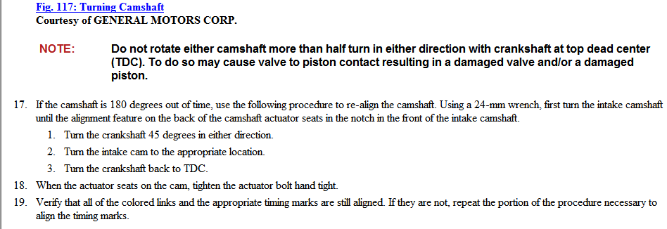

Did they before?
Did you follow these directions? Especially the marking part.

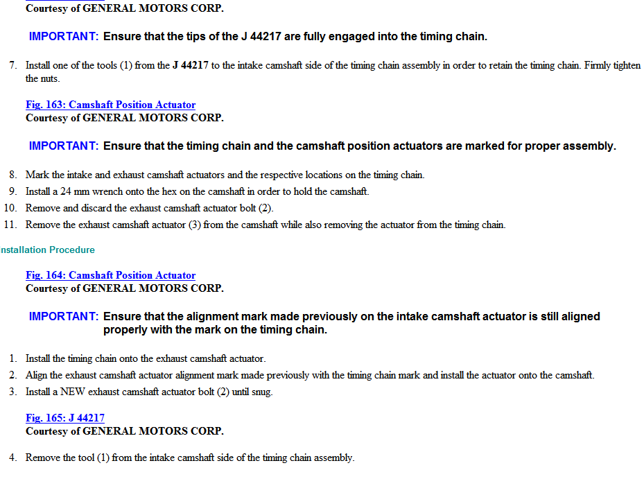

And this :
