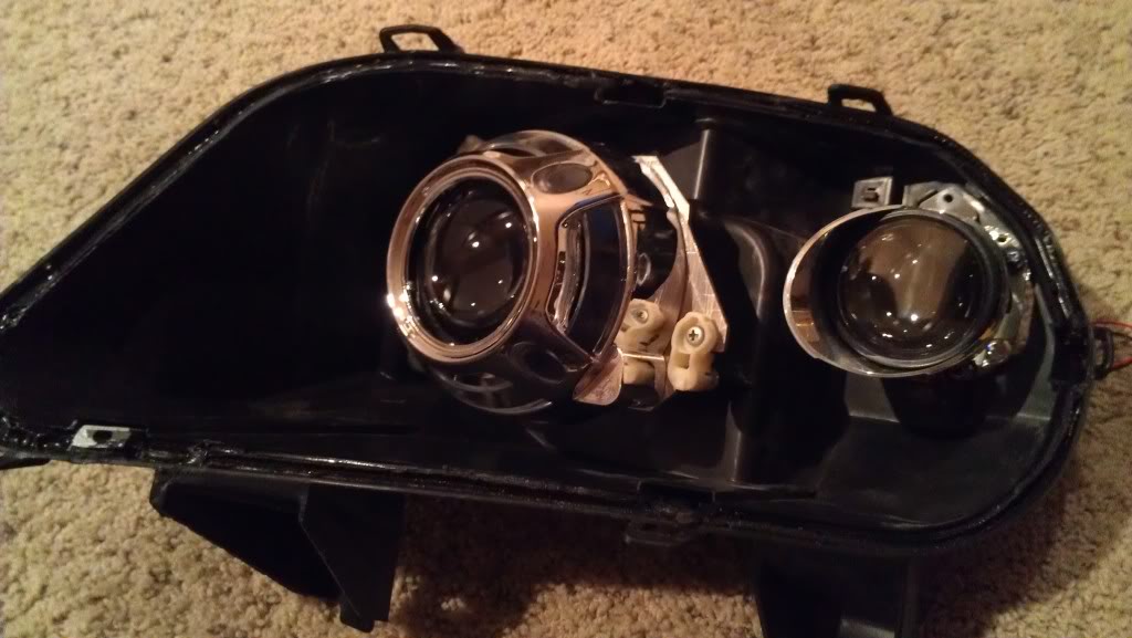

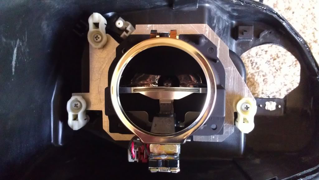

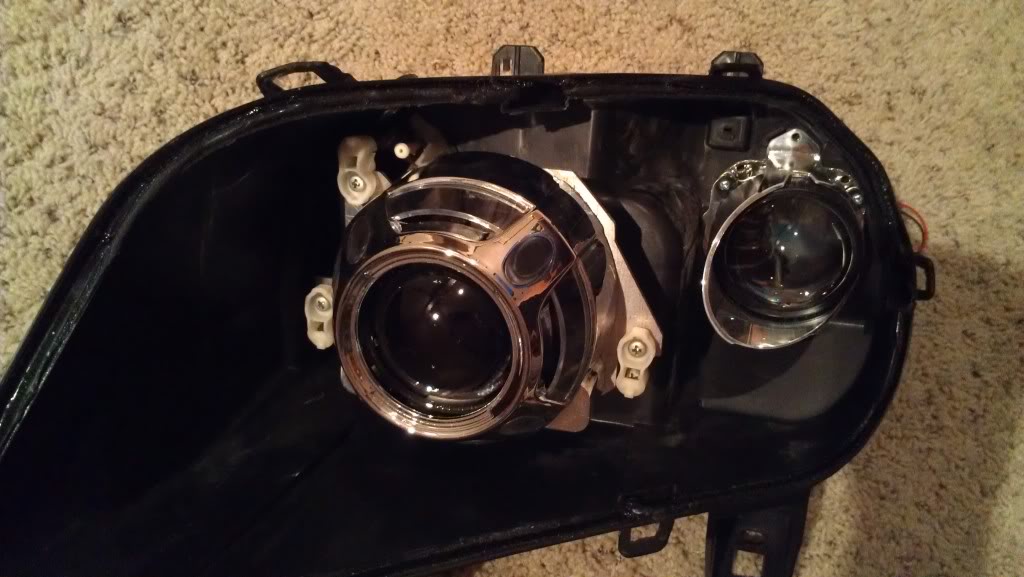

And now the updated pics...

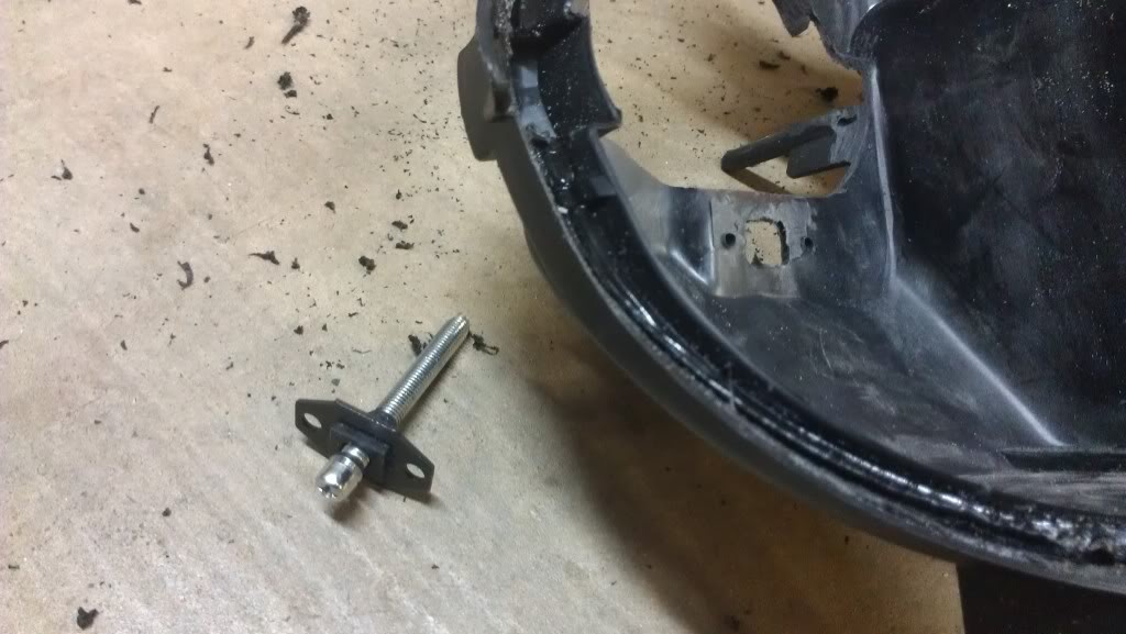

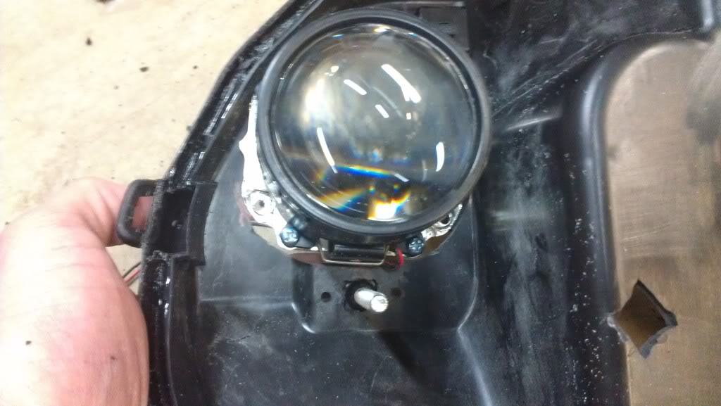

Old Apr 5, 2012 | 01:31 PM
trucky's Avatar
Joined: 12-28-2010
Posts: 89
From: Corona, CA

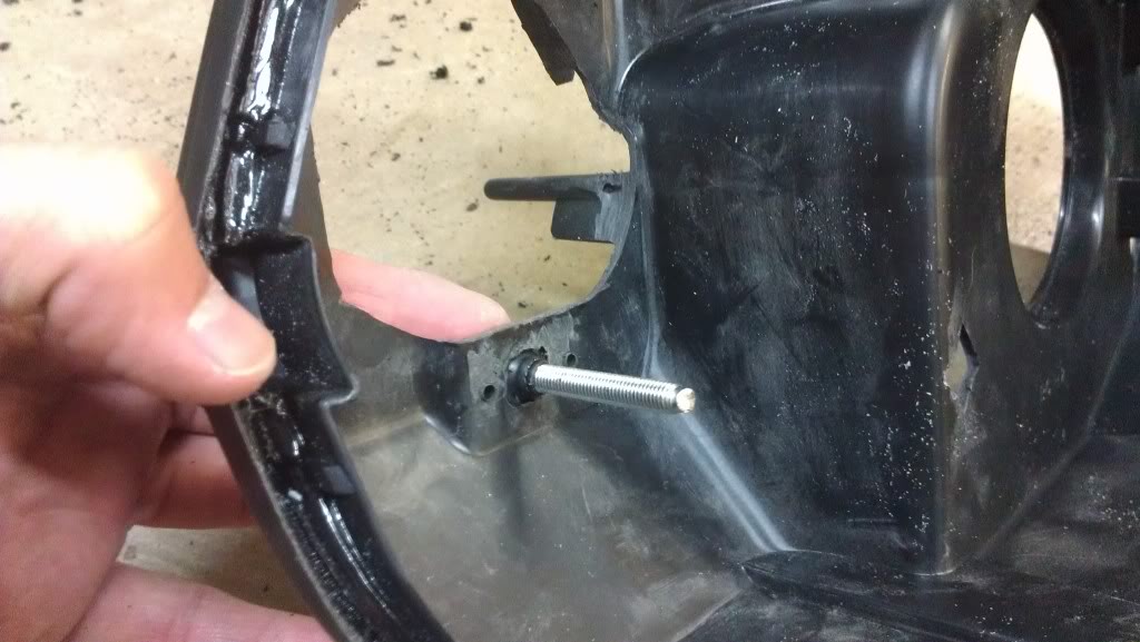

Alright, haven't updated this site in a while. I got some work done on one of the brackets, took me over an hour for just the one! Still have to do the other, but it'll have to wait a couple weeks till finals are over at school.

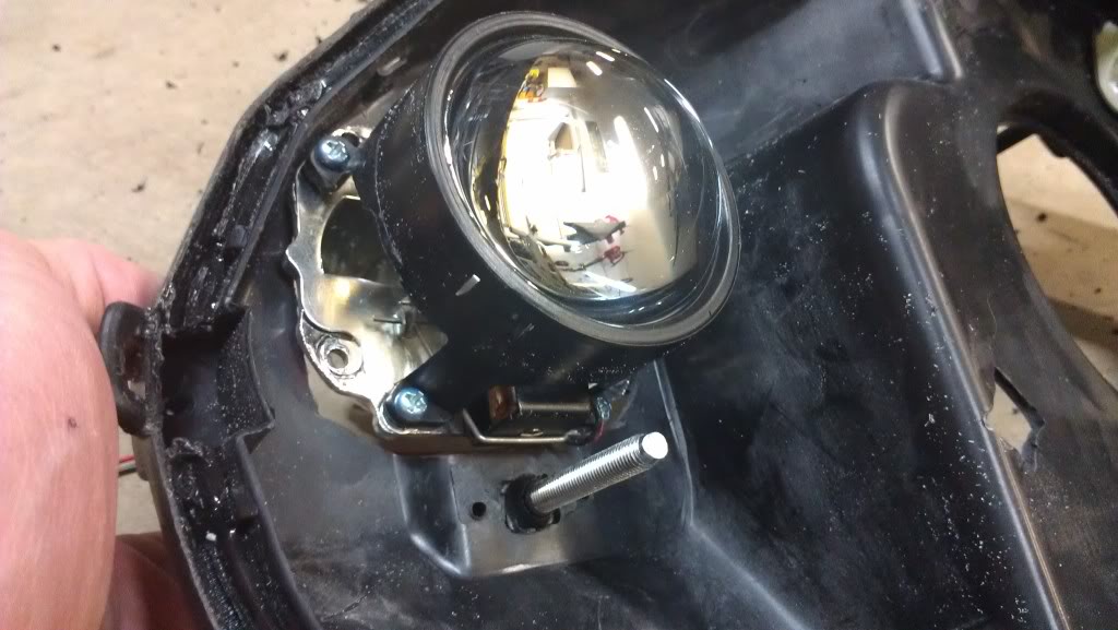

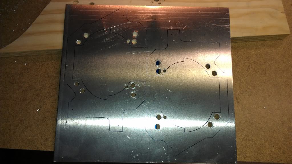

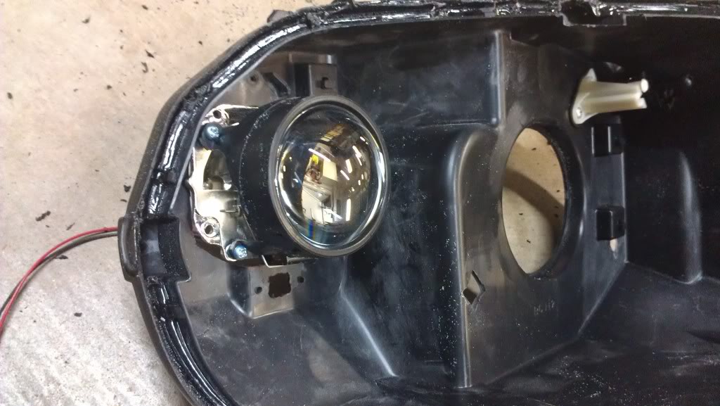

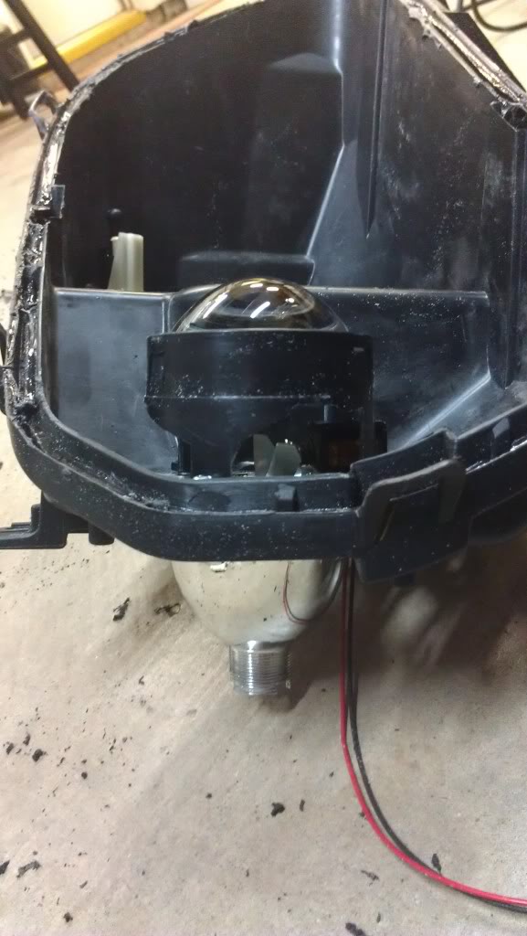

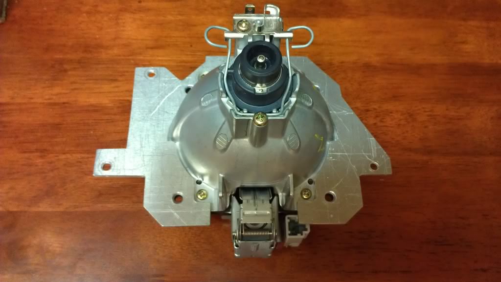

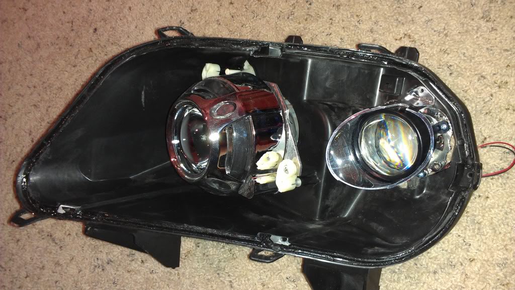

Now the bracket...

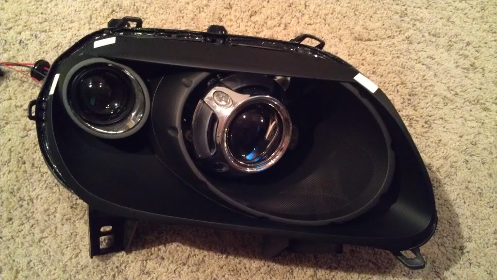

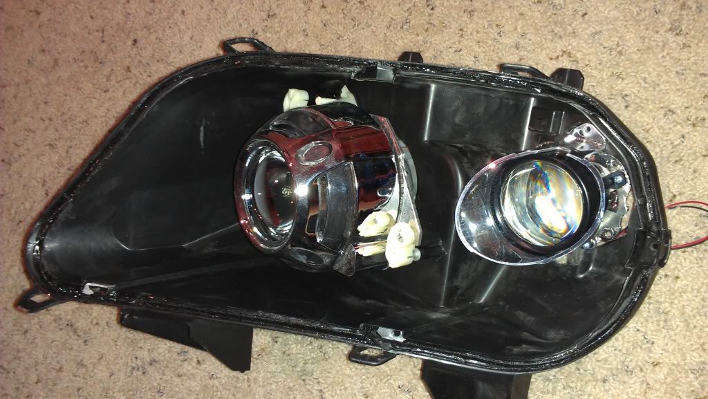

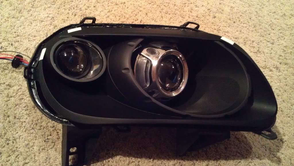

Here, I have everything just mocked up.

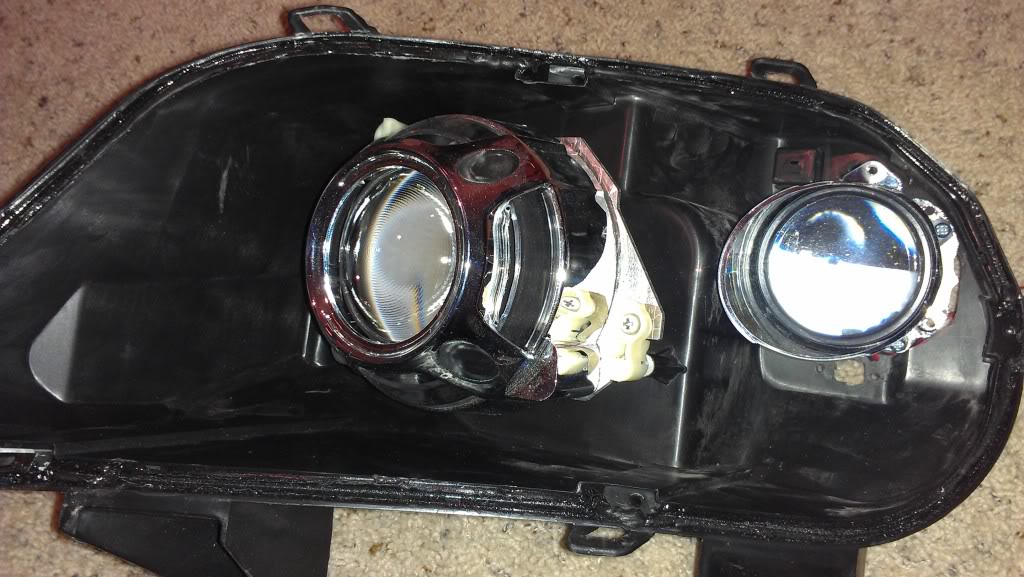

Update:

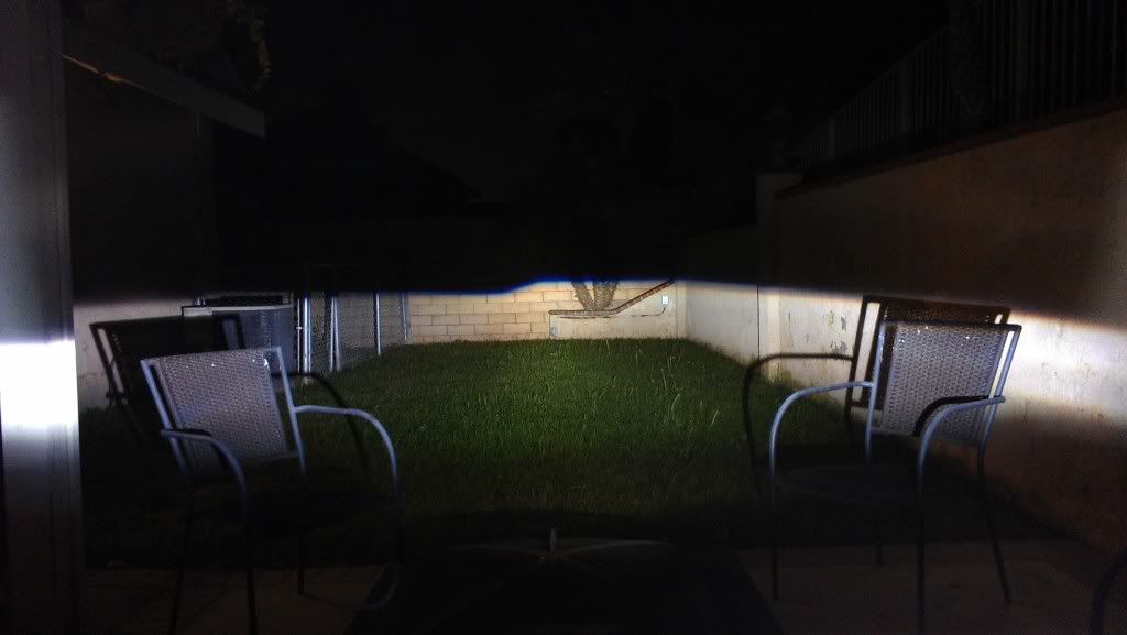

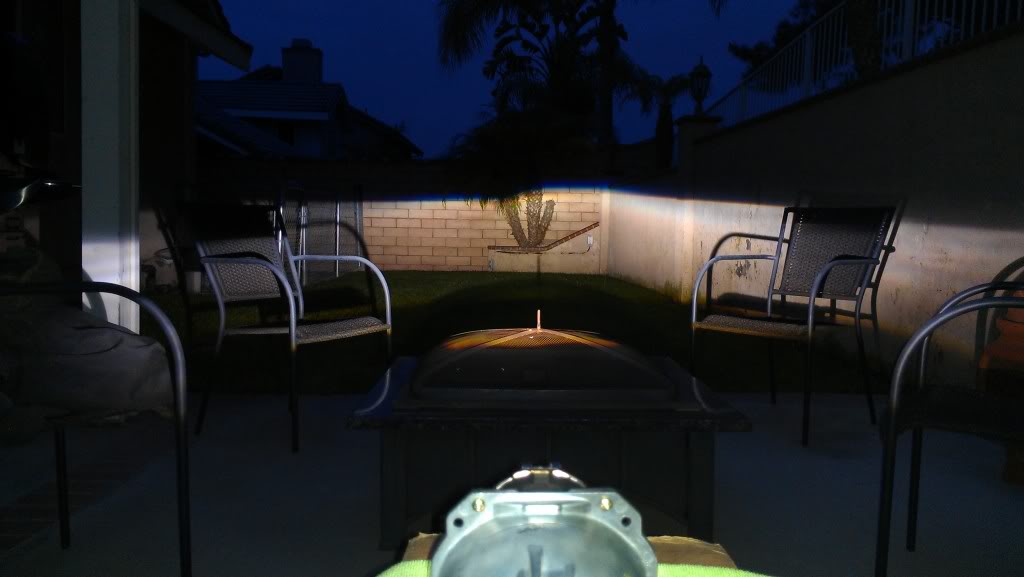

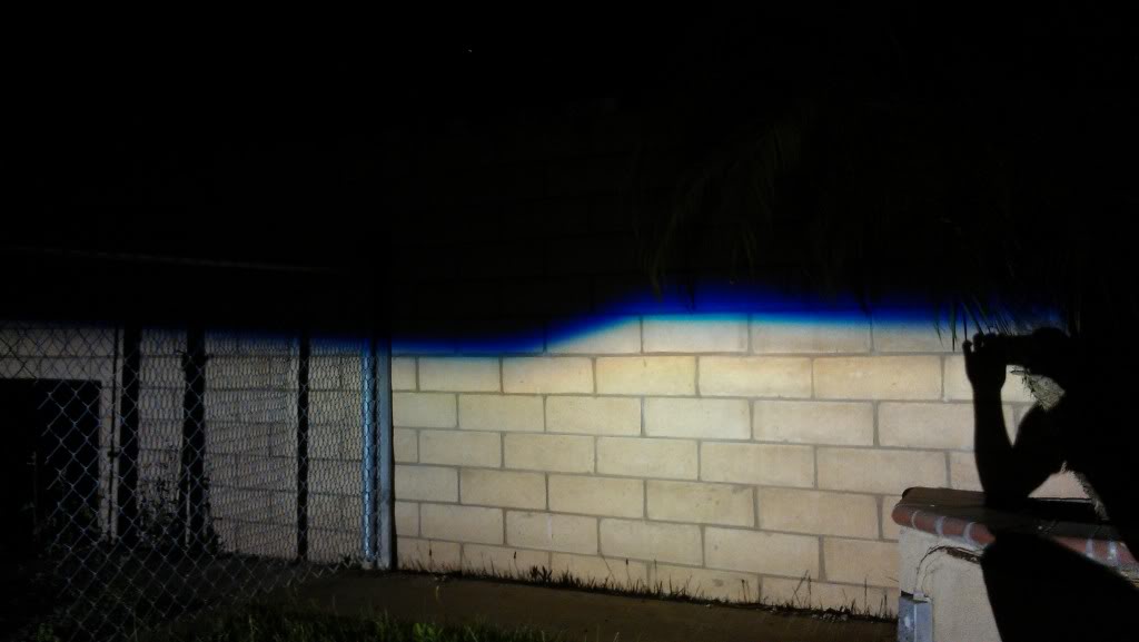

I did some work the other day on the Mini H1 projectors. I sanded the step cutoff so that it is now a slope. Then I painted and baked everything with VHT flat black ceramic header paint.
After taking some output shots of these little guys, I think I'm gonna dedicate these to only low beams. I hear too many complaints about how the shields don't always go back to a full upright position, and I don't want to lose the awesome color band!
Here ya go...
(ISO 200)
(And the rest are ISO 400)
